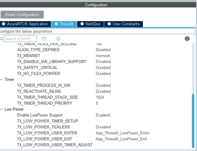

I configured ThreadX for low power:

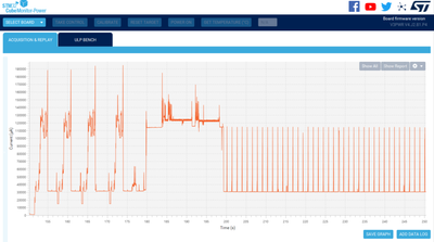

I use the StLink-V3-PWR and am measuring this current draw from startup to "sleep".
Any help or ideas would be greatly aprreciated.
