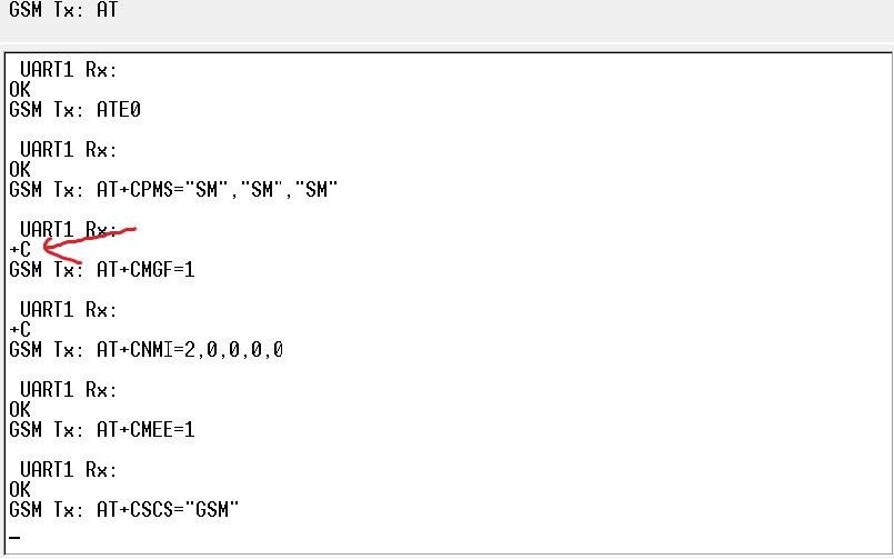

This is the source code what is running for GSM COM,
UART1 for Quectel M95,UART2 is for Hyper terminal.UART not receiving full reply message.
uint8_t test_commands()
{ send_cmnd((char *)''AT\r'',''OK''); send_cmnd((char *)''ATE0\r'',''OK''); send_cmnd((char *)''AT+CPMS=\''SM\'',\''SM\'',\''SM\''\r'',(''+CPMS: SM,0,50,SM,0,50,SM,0,50'')); send_cmnd((char *)''AT+CMGF=1\r'',''OK''); send_cmnd((char *)''AT+CNMI=2,0,0,0,0\r'',''OK''); send_cmnd((char *)''AT+CMEE=1\r'',''OK''); send_cmnd((char *)''AT+CSCS=\''GSM\''\r'',''OK'');return 0;
}void send_cmnd(char *AT_cmd_string,char *response_string)
{char send_Buf[50]={0};//added
sprintf(send_Buf,AT_cmd_string);uint8_t len = strlen(AT_cmd_string);
printf(''\r\nGSM Tx: %s\r\n'',(int8_t*)AT_cmd_string);
if(len)
{HAL_UART_Transmit_IT(&huart1,(uint8_t *)send_Buf,len);
}HAL_Delay(2000);reponse_read(response_string);}
void reponse_read(char *response_string)
{ uint8_t len1; len1=sizeof(response_string);HAL_UART_Receive_IT(&huart1,(uint8_t *)uart1_aRxBuffer,(len1+5));
HAL_Delay(500);
printf(''\r\n UART1 Rx:%s\r'',uart1_aRxBuffer); len1=0;}And the hyper terminal Displays below :
At the red mark we are expecting result :
''+CPMS: SM,0,50,SM,0,50,SM,0,50'' but not sucesses

2016-12-15 5:27 AM
I'm guessing how long does it take to send 'UART1 RX:' and how many bytes I may received in this time?
Try this: inside the interrupt of receiving a byte from Quectel, directly send and write the debug UART the same byte, and make sure the debug UART baud rate is higher (so you don't need extra buffering). When you write your 'GSM....' string,
send_cmnd((char *)'AT+CPMS=\'SM\',\'SM\',\'SM\'\r',('+CPMS: SM,0,50,SM,0,50,SM,0,50')); anticipate and add immediately the UART1 Rx: string before sending. Then it might work better. Let us know.
2016-12-15 12:05 PM
The response you are seeing makes perfect sense because your logic is completely confused.
Regardless of the command, this is the way your logic is currently working:
1. You transmit a string (command) to the M95 like AT+GSM.....
2. You delay 2 seconds, during which time the M95 sends a response
3. you THEN enable the UART to receive data, using interrupts (and I still don't see your interrupt handling code)
4. the result of (2) above is that the response from the M95 happens while you are sitting in a 2 second delay. As a result you get whatever was received by the hardware before it overflowed because you are not emptying the Rx buffer as characters are coming in. So you get the first 2 characters '+C' which is the beginning of '+CPMS....' but since nobody is looking at the receiver, after the first two characters are buffered in the hardware peripheral (in the Rx register and the CPU interface register) it drops all subsequent characters on the floor. The whole message was sent back by the M95 while you are sitting in a delay loop and ignoring what is coming back for 2 seconds. So when you finally enable the Receiver with your HAL call it gives you the two characters it had stuck in the peripheral's registers.
What you need to do is enable the Receiver BEFORE you send a command so that you get back anything that the M95 sends you. Including the command you sent if you have Echo enabled. YOU need to figure out what to expect back based on whether echo is on or not, etc etc etc, and throw out any extraneous information and extract the useful response. You can't use delays to hope that the bad stiff gets ignored and you'll get the good stuff because you don't know how long it will be before the M95 responds.
By waiting 2 seconds to look at the receiver after sending a command, you are ignoring the response from the M95.
And as a side note, setting a receive buffer 5 characters bigger than the size of the buffer you were passed is dangerous at best. (assuming this will even know what the size is since what is passed to the function is pointer to an arbitrary array)
If you would like me to write the code for you, let me know.
