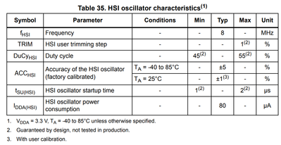

Accuracy of the internal RC oscilator (HSI) is given in the datasheet. It says +/- 5% is typical without calibration. If you allow 15%, that seems fine to expect without any further steps. Calibrating it will improve accuracy.
But it's so easy to add a crystal and get, say, 50 ppm accuracy. If you are timing things, it seems silly not to.
