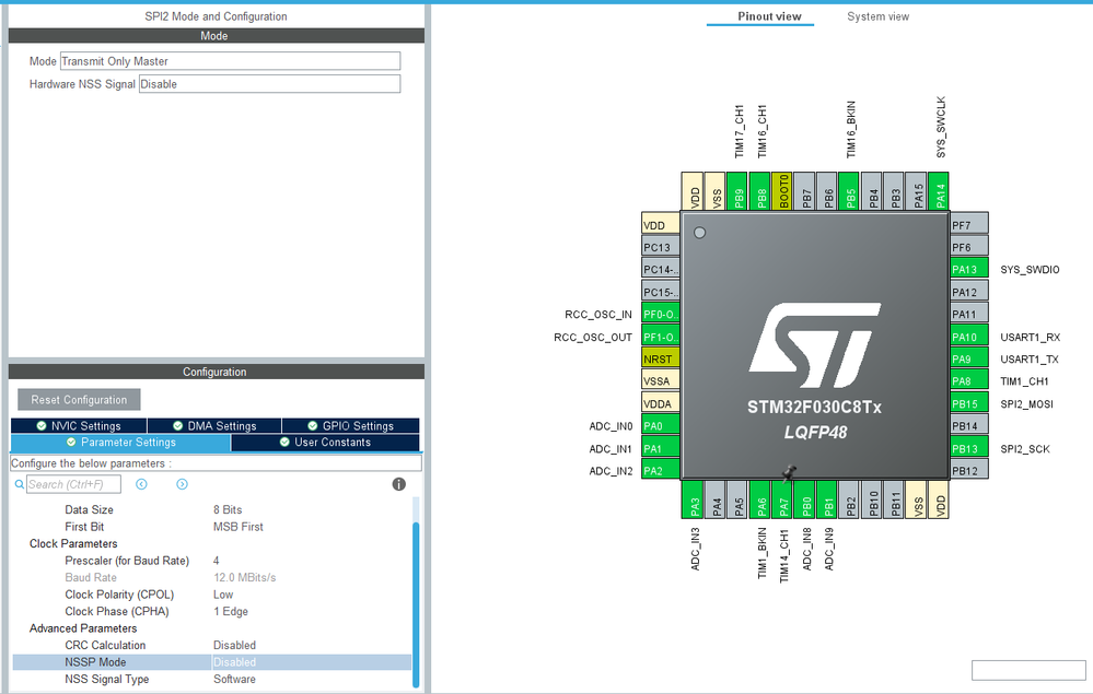

I am trying to connect LCD (SPI interface) to my custom stm32f030c8 board, PB13 -> SCK, PB15 -> MOSI (Transmitt only mode).
I created a test project with cube configurator (attached a screenshot).
I did not change anything in the generated code, just added sending test:

}I uses ST-Link to debug. All initializations pass so as the transmit subroutine, but there are no any signals on MOSI and SCK appears (I use oscilloscope with sync by signal front). I tried to change pins mode to general outputs and to toggle output levels manualy, and I got that levels on my oscilloscope, so there are no broken lines.
In SR register only TXE is set, in CR1 register SPE is set, all seems to fine.
So why there are no SPI signals?
