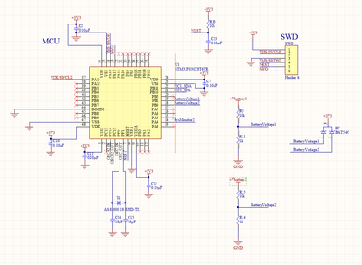

Hi ST Community,
I am trying to measure system voltage (Lead Acid Battery) using ADC input of STM32F030C8 (PB1). The system voltage can be between 9V and 13.5V () so I am using voltage divider (10k and 1k) to lower the voltage to the 0 - 3.3V range. I am using STM32 Cube IDE. I am making ADC measurements/checking voltage in every 100ms.
The problem is I am getting huge fluctuations when reading the voltage. For example, I am getting values between ~11.8V and ~12.3V, when the system voltage is around 12.09V (checked with multimeter). I am not expecting to get exactly 12.09V, but 200 - 300mV offsets/errors are huge for me. I am calibrating the ADC channel before measurement but the error is same.
Could you please help me to this issue? Thank you in advance

You could increase the sampling time of your ADC channels from 13.5 to the biggest number possible. When the mux of the ADC switches channels there can be some transience, so in general the longer you can sample the better. You could also add oversampling to each channel. Lastly, you could try taking two samples on a channel, one right after another, then throw the first one away and keep the second one. All these are different ways to prevent any signals bleeding from one channel to another.
2024-02-02 3:19 AM
If you connect a constant voltage source directly to the ADC input channel to "emulate" your battery voltage, do you have the same behavior?
PS: see this AN2834 "How to optimize the ADC accuracy in the STM32 MCUs". It may help you.
2024-02-02 3:53 PM
