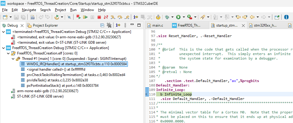

I'm trying to create a minimal example of blinky using an RTOS task in STM32CubeIDE. My MCU is a bare STM32F070CBT6. The code ends up in Default_Handler just a moment after the start

#endif /* USE_FULL_ASSERT */My assumption was that such a minimal example should work right off the bat but apparently that's not the case :)
Could someone point me at what I'm missing here please?

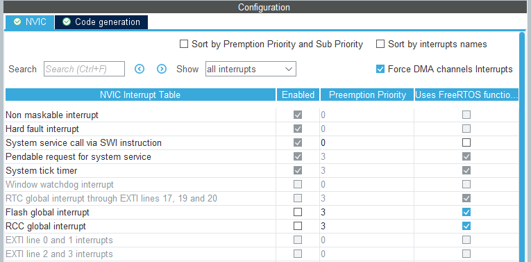

I think you need to disable WWDG in NVIC.
2025-02-18 7:45 AM
I believe it's disabled
I didn't touch any defaults.

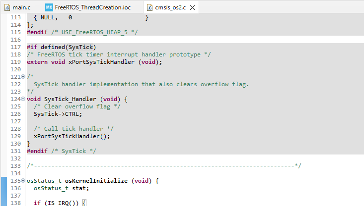

2025-02-18 8:36 AM
I can't find SysTick_Handler implementation anywhere though. Neither in port.c, nor in stm32f0xx_it.c
When I implement an empty handler the execution constantly ends up in it. I am a novice at embedded programming but I feel like this might be the issue. Also I found this thread that can be related.
2025-02-18 8:43 AM
Should this be grayed out, and if not, how to fix that?
