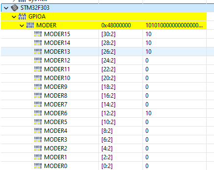

> registers appear correct
Show - both TIM and GPIO.

2025-02-18 12:24 PM - edited 2025-02-18 12:25 PM
I think you missed the part of @waclawek.jan's post where he noted you are setting AF for pin PA2, not PA6. This error is confirmed in your register values.
> Why GPIO_AFRL_AFRL2_Pos for PA6?
2025-02-18 12:54 PM
@TDK Yes, what a *** mistake! I missed that, everything works fine.
