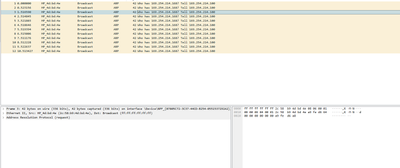

2025-02-18 3:54 AM
This is the log when I try to ping from pc to stm32.
I tried to ping from pc to raspberry pi with same cable and same target ip and it was successfully done. I need to see ping communication between pc and stm32f767zi over ethernet.
