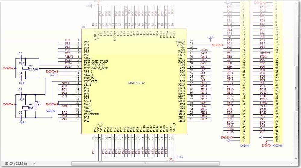

Well the STM32 part is unreadable.

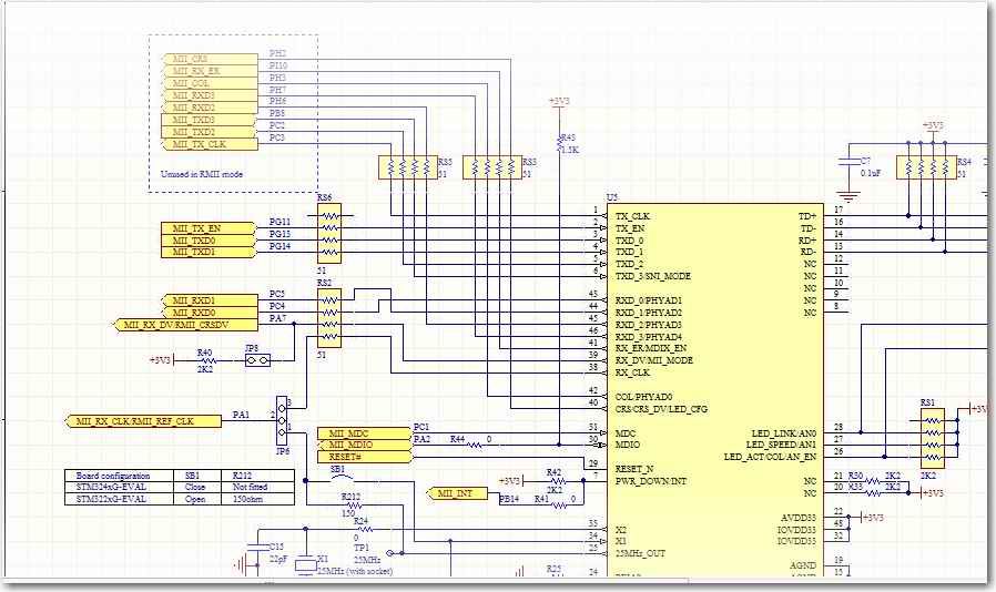

The PHY part, you have no pull-up on PWRDWN_INT, RBIAS has a 4K7 to an unconnected net, Neither pin 38 or 39 are connected properly to the STM32, pin 40 shouldn't need to be.2015-07-30 1:33 PM

Here's STM32 schematic......on the chip area, it's simple.....I don't put anything special.... some capacitors and power supply are not displayed......making the image smaller and can't be seen......accept I can send the pdf file....attached...2015-07-30 5:57 PM
Ok, figured out what you're doing with the RBIAS.
The pin 39/40 stuff troubles me16 PC1 ETH_MDC Pin 31
24 PA1 ETH_REF_CLK Pin 38 ETH_RMII_REF_CLK
25 PA2 ETH_MDIO Pin 30
32 PA7 ETH_CRS_DV Pin 39 PD8 ETH_RMII_CRS_DV ETH_MII_RX_DV
33 PC4 ETH_RXD0 Pin 43 PD9 ETH_RMII_RXD0
34 PC5 ETH_RXD1 Pin 44 PD10 ETH_RMII_RXD1
48 PB11 ETH_TX_EN Pin 2
51 PB12 ETH_TXD0 Pin 3
52 PB13 ETH_TXD1 Pin 4
Take a look at the STM32MICOS-EVAL schematic cited earlier
Need to look at the 25 MHz vs 50 MHz clock for the PHY

/**ETH GPIO Configuration PC1 ------> ETH_MDC PA1 ------> ETH_REF_CLK PA2 ------> ETH_MDIO PA7 ------> ETH_CRS_DV PC4 ------> ETH_RXD0 PC5 ------> ETH_RXD1 PB11 ------> ETH_TX_EN PB12 ------> ETH_TXD0 PB13 ------> ETH_TXD1 Do I miss something here ? from this link : http://www.st.com/st-web-ui/static/active/en/resource/technical/layouts_and_diagrams/schematic_pack/stm322xg-eval_sch.zip2015-07-31 6:56 AM
Do you reckon I connect pin 39 to PA7 ? I can give a try by patching the pcb....thanks

I have used STM32CubeMX32 with custom board hosting Stm32F107 with LAN8720 PHY and RMII interface..
And it works great! Just to note source code created by cube is for DP83848 PHY.. RMII being standard common registers are configured fine..just watch out for extended(vender specific) register like.. PHY_SR PHY_MICR PHY_MISR just comment HAL_ETH_WritePHYRegister() for those register in ethernetif.c file to avoid setting wrong config for unintended register. OR Set correct address and mask for those register while configuring cube in Configuration>ETH>Advance parameter>extended section. Other hardware issue I had was I was getting RX packes but no TX packets. So I scoped MAC to PHY link specifically Eth_TX_En and Eth_Crs_Dv [Packet reception and transmission pins ] and it was bad soldering for TX side. Symptom of this issue is for ping you can see PHY link led blinking but destination unreachable as TX side fails. //--------------------------------------------------------------------------- For tcp_echoserver_init(); I have added Tcp_echo_server.c file from other example project. But Ping should work without it. int main(void) { /* USER CODE BEGIN 1 */ /* USER CODE END 1 */ /* MCU Configuration----------------------------------------------------------*/ /* Reset of all peripherals, Initializes the Flash interface and the Systick. */ HAL_Init(); /* Configure the system clock */ SystemClock_Config(); /* Initialize all configured peripherals */ MX_GPIO_Init(); MX_LWIP_Init(); /* USER CODE BEGIN 2 */ tcp_echoserver_init(); /* USER CODE END 2 */ /* Infinite loop */ /* USER CODE BEGIN WHILE */ while (1) { MX_LWIP_Process(); /* USER CODE END WHILE */ /* USER CODE BEGIN 3 */ } /* USER CODE END 3 */ }2016-01-05 5:05 PM
