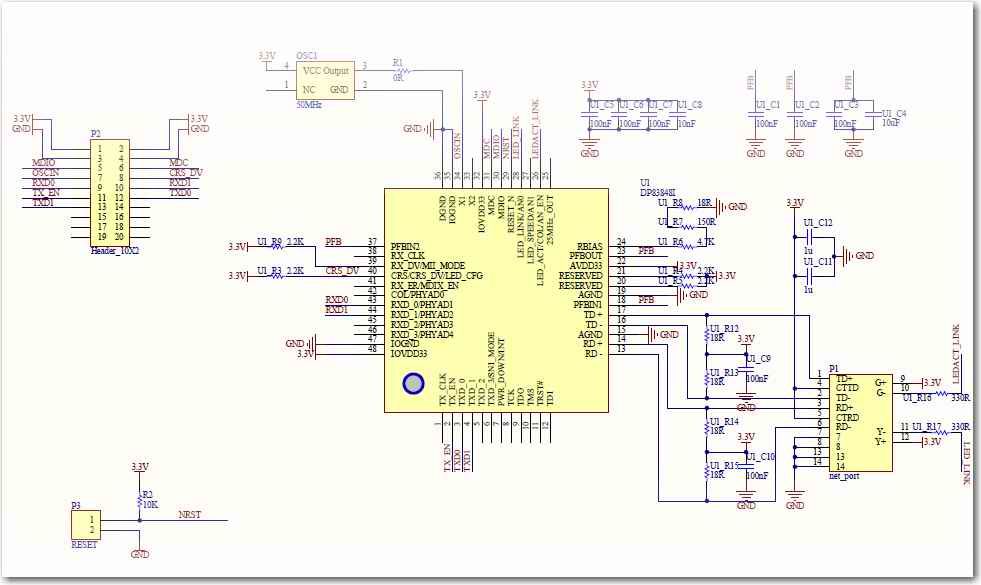

No idea, I don't even know if the hardware design is viable, having no insight into the schematic or BOM. If you think it's a software problem you could look at SPL and STM3210C-EVAL examples. For hardware the counter point would be someone elses working board/design.2015-07-25 8:32 PM

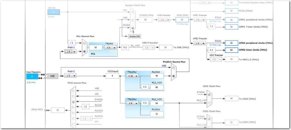

Is my clock configuration acceptable ?
I make it with STM32CubeMx2015-07-30 5:25 AM

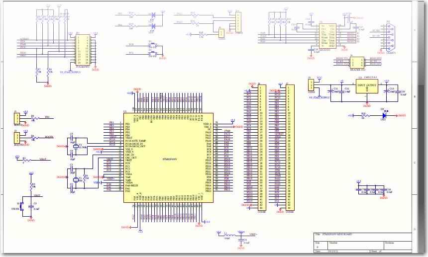

Not sure why you're clocking the CPU at 50 MHz, I'd think the PLL would permit 72 MHz operation. Assuming your PHY has it's own crystal, lacking a schematic.2015-07-30 7:26 AM
The Schematic, I changed the crystal of STM32 to 25MHz...and see what happens...
