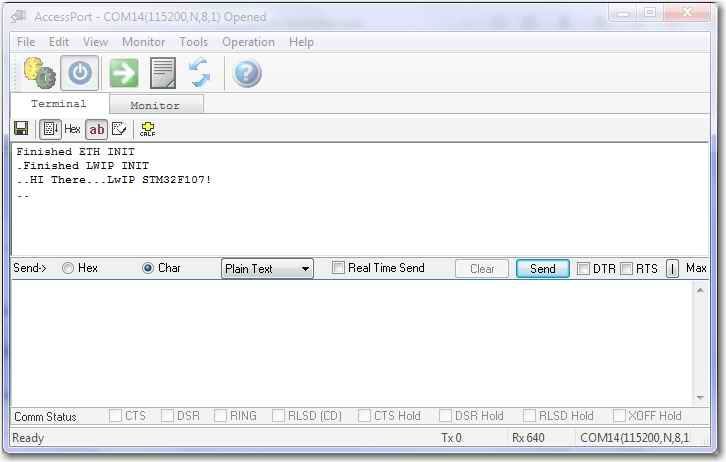

} with UART I get a response from this function above,
LINK UP! ..LINK DOWN! Finished LWIP INIT
Why it's saying UP then DOWN ??? Is it because of non cross-over cable ?
How do I know my cable is cross-overed or not ?
I see in my cable : ''verified cat6a patch cable'' but it doesn't say cross-over or not ?...

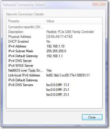

Hi clive1,
I still can't not ping it, I used a switch and straight cable, the LED on the switch are blinking... Here's the IP address for cubemx IP_ADDRESS[0] = 192; IP_ADDRESS[1] = 168; IP_ADDRESS[2] = 1; IP_ADDRESS[3] = 12; NETMASK_ADDRESS[0] = 255; NETMASK_ADDRESS[1] = 255; NETMASK_ADDRESS[2] = 255; NETMASK_ADDRESS[3] = 0; GATEWAY_ADDRESS[0] = 192; GATEWAY_ADDRESS[1] = 168; GATEWAY_ADDRESS[2] = 1; GATEWAY_ADDRESS[3] = 1; and the UART output when I tested it :Finished ETH INIT
.Finished LOW LEVEL INIT! /n.È.. -éøOLINK UP!
..LINK DOWN!
....È.. FinishedFinished LWIP INIT
..START LISTENING!
..µ
F.
�??h±FTCP_echoserver_init DONE!
.È.. }IHI There...LwIP STM32F107!
..Inside Low level input ethernetif.c!
..Buffer value:
.-éð_'H
FÆj. ?FFÖø 1à0hÿÿÿÿÿÿÈ
©qGà.E..N.í..€µXÀ?
À?ÿ.?.?.: my IP address on the computer :
..LINK DOWN!
..START LISTENING!
..µ
F.
..Inside Low level input ethernetif.c! any clues ? ?
