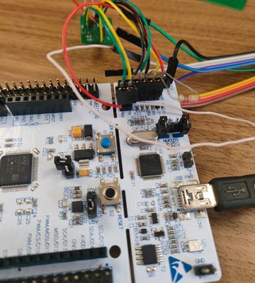

I was using a custom board for the C031G6U6 that was connected to the Nucleo's St-Link, board model MB1136. The 3V3 power comes from the Nucleo(connection made under the board), and the embedded MCU is disabled by the JP6.
Original connection
All pins were connected as described on the CN4 documentation.
CN4 Pins
It was discovered that disconnecting the NRST pin from the Nucleo board eliminates the problem!
I don't know why but, that's it. The custom board seems to be ok, it already had the 100nF cap.

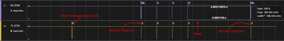

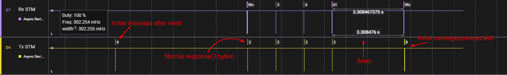

Hello! I will post some images of the signals.
In the beggining of the code, the STM sends a 9 bytes message once. After, it waits for blocks of bytes and reply the messages with a two byte response. Just that.
In the first picture, the first message received constains 270 bytes, and is correctly received (I checked in debug). Some more messages are received and the first one is repeated again in the end with a delay of 5,3s, and no problem occured.
In the second picture, it's exactly the same situation, but the delay of the last message is smaller. And the STM replies with the 9 bytes initial message, that could only occur after a reset.
Capture WITHOUT Error
Capture WITH Error
I also checked the RCC_CSR2 after the resets(it's in the initial message), and the value is: 0x04000000. Indicating Bit 26 PINRSTF: Pin or other system reset flag
