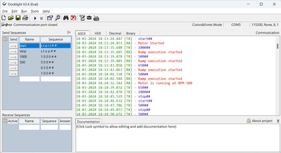

}Issue 1: after completion of first ramp execution i am getting message from UART "Motor is running at RPM 650" . Thereafter other commands are not working

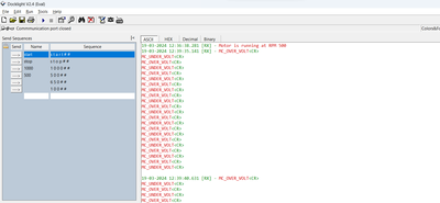

Issue 2: I have set the timer interrupt for 5s to check error conditions, i should receive error messages once every 5s
but that is not happening here
