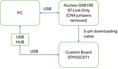

My setup diagram is as below:
Removing any of the USB cable in above setup, leads Windows 11 on my PC to remove USB serial device appearing in device manager. I tried without USB hub too, results are same. I tried connecting only Custom Board or only Nucleo-G0B1RE board and observed that in either case, USB serial device does not appear on PC. I also tried connecting both with PC but disconnected 5-pin downloading cable and observed that USB port does not appear on PC. It appears only when complete setup shown in above diagram is connected and powered up.
Please help me in understanding this scenario and resolving the problem as I want my custom board USB port to appear as COM port on PC (offcourse without STLink).
