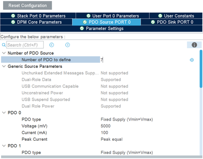

I am using the STM32ubeMX v6.14.0 to generate a USB-PD DRP following the link below:
I noticed that when I set the CubeMX to have more than 1 PDO, say 7, the macros USBPD_MAX_NB_PDO and PORT0_NB_SOURCEPDO are correctly set to 7 but the USBPD_NbPDO[1] has a value of 1 and I see that only the first element of the PORT0_PDO_ListSRC array is populated. Moreover, I also noticed that the USBPD_PWR_IF_SetProfile function is fixed to get only the first PDO due to explicitly choosing PORT0_PDO_ListSRC[0].

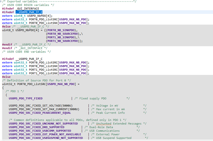

2025-04-09 12:09 AM
Hi @FBL,
This might be an issue related to the same post in here:
When I define the PDOs in the CubeMX, the PORT0_PDO_ListSNK and PORT0_PDO_ListSRC are present in the usbpd_pdo_defs.h but are disabled through the #ifndef __USBPD_PWR_IF_C as you can see in the image below (even though __USBPD_PWR_IF_C is defined in usbpd_pwr_if.c).
