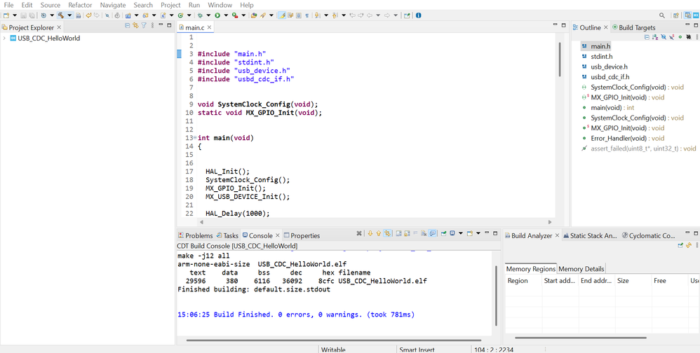

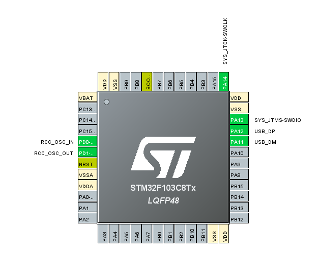

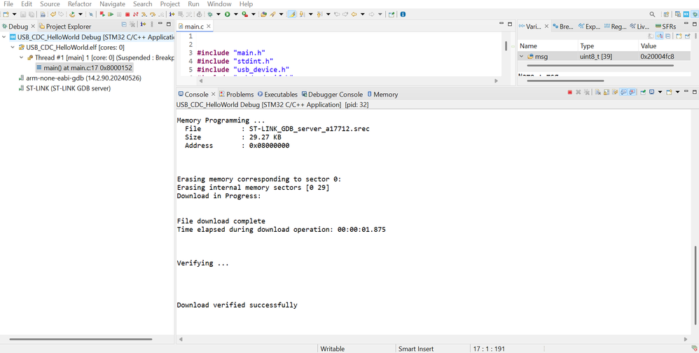

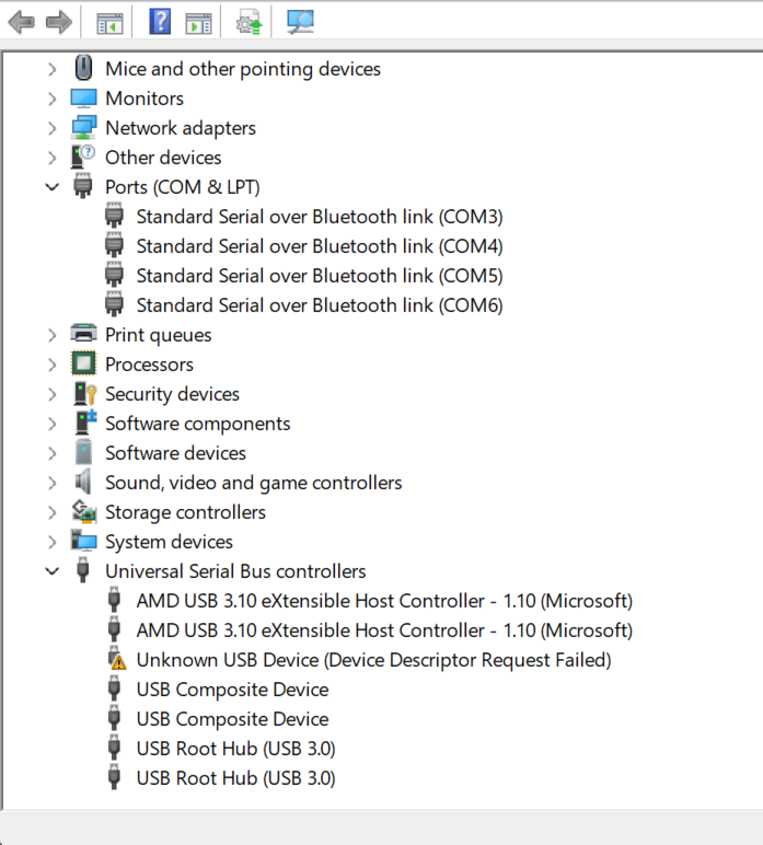

So I'm using a custom made STM32 board having STM32F103C8T6 MCU and after debugging the board using ST Link V2 when I try view the output through USB on my pc using the virtual COM Port and it is not working. As well as I have tried to view the output on the debugger console but it is showing temporary breakpoint for HAL_Init() . If their is any other way to view the output I would love to try and also the drivers I have install from STM32 website are for Win 7,8 versions and when I am connecting my board to my PC and opened the device manager to check the COM Port, in their under Universal Serial BUS Controller it is showing as a Unknown Device with a yellow caution sign. Do i need to have the latest drivers to view the output on Serial Wire mode?? and where can I find the latest driver for Win 11. I have attached the Pin configuration of my board and the code I am using below such that it can help you to understand the problem I am going through. Please guide me through the issue such that I can solve this problem. Also if possible please guide me through how to view the output such as simple Hello World print using the UART or any other possible way to see the output.

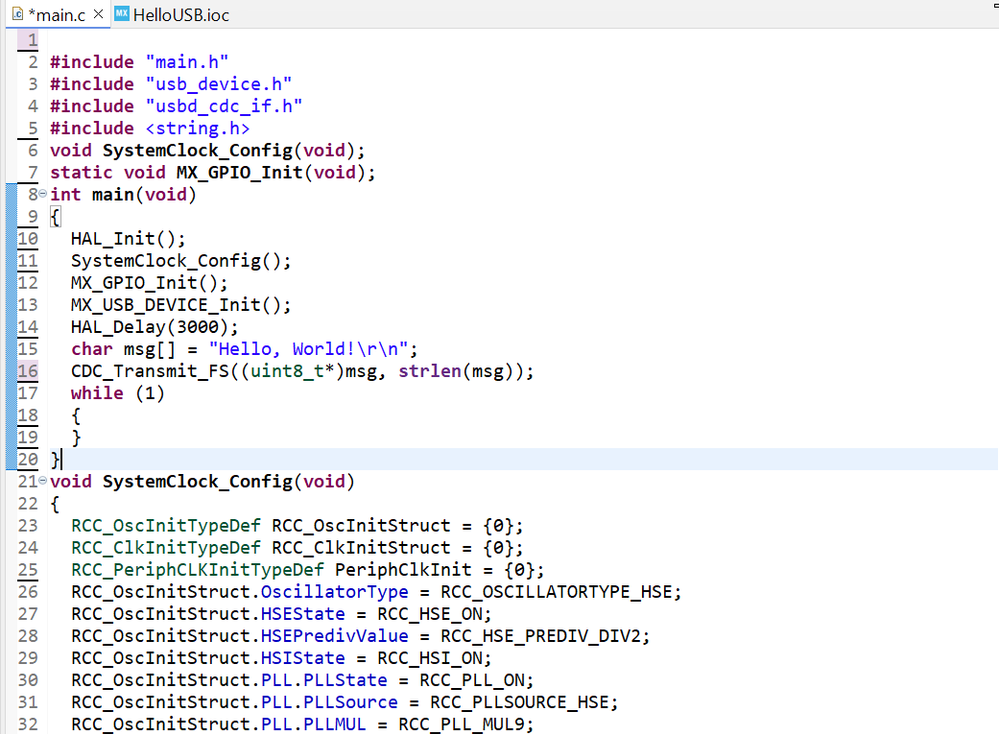

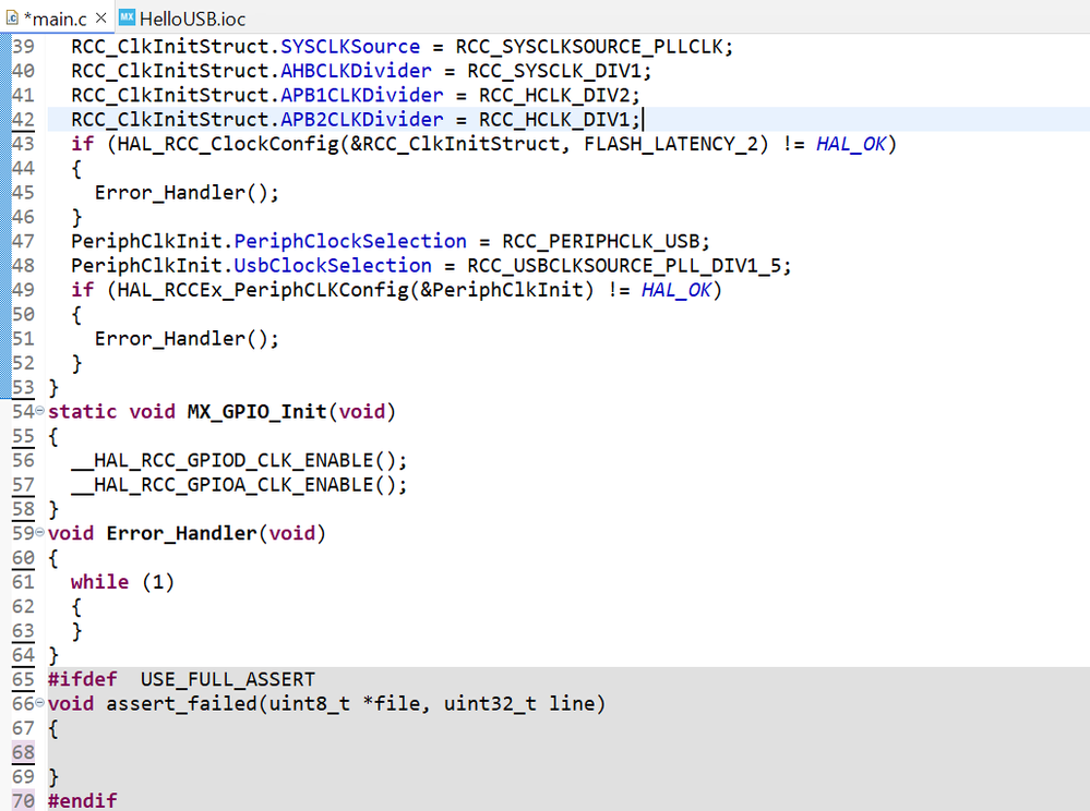

So I have attached the screen shoots to support my answer.
So this is the that I'm using for my STM32 Custom board. Please look into this any if any changes required let me know and also if their is any way round I would love to try that.
#include "main.h"
#include "stdint.h"
#include "usb_device.h"
#include "usbd_cdc_if.h"
int main(void)
HAL_Init();
SystemClock_Config();
MX_GPIO_Init();
MX_USB_DEVICE_Init();
HAL_Delay(1000);
uint8_t msg[] = "Hello, World from STM32 via USB CDC!\r\n";
CDC_Transmit_FS(msg, sizeof(msg) - 1);
while (1)

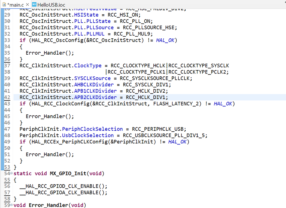

void SystemClock_Config(void)
RCC_PeriphCLKInitTypeDef PeriphClkInit = {0};
RCC_OscInitStruct.HSEPredivValue = RCC_HSE_PREDIV_DIV1;
RCC_OscInitStruct.HSIState = RCC_HSI_ON;
RCC_OscInitStruct.PLL.PLLMUL = RCC_PLL_MUL9;
Error_Handler();
RCC_ClkInitStruct.APB1CLKDivider = RCC_HCLK_DIV2;
RCC_ClkInitStruct.APB2CLKDivider = RCC_HCLK_DIV1;
if (HAL_RCC_ClockConfig(&RCC_ClkInitStruct, FLASH_LATENCY_2) != HAL_OK)
Error_Handler();
PeriphClkInit.PeriphClockSelection = RCC_PERIPHCLK_USB;
PeriphClkInit.UsbClockSelection = RCC_USBCLKSOURCE_PLL_DIV1_5;
Error_Handler();
__HAL_RCC_GPIOD_CLK_ENABLE();
__HAL_RCC_GPIOA_CLK_ENABLE();

@Ratul99 wrote:So I have attached the screen shoots to support my answer.
Thanks. It would be nice to crop the images to just show the pertinent details - rather than the entire screen.
@Ratul99 wrote:
- It was showing as Unknown USB Device ( Device Descriptor request Failed).
So look into why your code is failing to give a valid Device Descriptor ...
