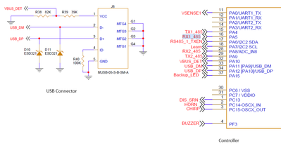

Hardware schematic is as follows:

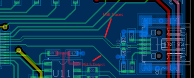

This problem is resolved. The root cause was found to be grounding issue. Custom board USB connector ground pin was not soldered properly due to which when STLink board was connected to custom board, the ground pin in downloading cable of STLInk board established ground connection of custom board with Host PC. This made USB to work but as soon as STlink board is removed the ground connection got disconnected and USB port was seen removed by Host PC.

2025-03-25 10:21 AM
@PPate.1 wrote:still my board is not visible on PC as VCP.
Does anything at all appear on your PC?
Have you verified good connections, no shorts, etc on your custom board?
Are you sure you're using a good cable, with full data connectivity?

Information about layout: 90 ohm differential impedance maintained.
