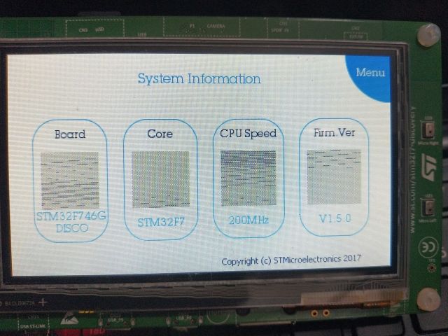

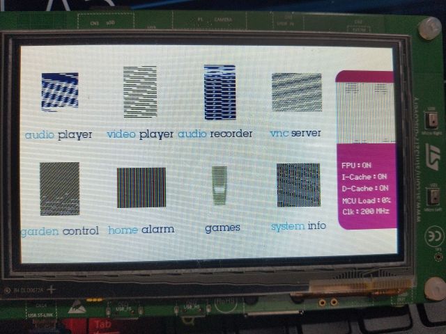

Thanks for response..!
I have flashed latest FW (V1.5.0.hex) last week. But, display screen becomes distorted (less resolution).
How to fix this issue?
"ST logo" Resolution is looks good during boot-up screen. (Boot-up pix not attached)
See attachments -
2019-02-11 8:35 AM
I think the images get pulled from external memory QSPI/NOR, you will need to select the appropriate External Loader for the STM32 Cube Programmer tool to write all the memories completely.
