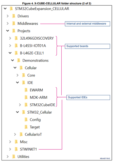

In the X-CUBE-CELLULAR Manual this picture is shown:
I downloaded the STM32CubeExpansion_CELLULAR_V7.1.0 ZIP File from the here and there is only one example in the demonstration folder:
Looking forward for help...
Best Regards
2023-07-12 5:26 AM - edited 2023-07-12 5:26 AM
The structure given in the document still refers to the older version 7.0.0 of X-CUBE-CELLULAR, the Release_Notes.html always contains the most recent description.
Older firmware versions can also be downloaded from this website; the default setting is always the latest version. In Get Software, you will find the desired version number on the far right under Select Version. You will then find the second example in the version 7.0.0 mentioned.
Hope that helps?
Regards
/Peter
2023-07-12 5:27 AM - edited 2023-07-12 5:38 AM
Hello @Chani ,
You can find the demonstration examples shared in the user Manual in X-Cube-Cellular version 6.0.0 : STM32CubeExpansion_CELLULAR_V6.0.0\Projects
Thank you for your contribution.
Kaouthar
2023-07-12 5:54 AM
Ok.. I just merged the STM32CubeExpansion_CELLULAR_FreeRTOS_V7.1.0 into the STM32CubeExpansion_CELLULAR_V7.1.0 folder and now I can compile the CellularIOT Project.
