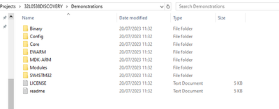

Hello. I have recently purchased STM32L0538-DISCO board and I want to play a bit with the E-paper display. After struggling for a couple of hours trying to find some sample code or projects to run on STM32CubeIDE, I have found somewhat relevant thread here:
I have located STM32_Cube_FW_L0_V1.12.2 on my PC and tried to follow the migration guide UM2579.
Unfortunately, I have not been able to migrate the project to STM32CubeIDE as I think the instructions are not fully clear.
My questions regarding migrating the project:
1. The first step in the guide mentions that I need to make a copy of the project and copy that inside the workspace currently being used in STM32CubeIDE. I cannot understand how to properly do that. First of all, when it refers to "make a copy of the project" which directory does it refer to exactly?
Does it refer to whole Demonstrations directory?
C:\Users\petrikas.lu\STM32Cube\Repository\STM32Cube_FW_L0_V1.12.2\Projects\32L0538DISCOVERY\Demonstrations\SW4STM32\STM32L0538-Discovery
Does it refer to SW4STM32 directory?
Or STM32L0538-Discovery directory?
Additionally, which files exactly do I need to copy?

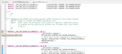

However, since I created a blank project using stm32CubeMX, I cannot build the project perhaps I am missing some configuration:
make -j16 all
arm-none-eabi-gcc "../Drivers/BSP/STM32L0538-Discovery/stm32l0538_discovery.c" -mcpu=cortex-m0plus -std=gnu11 -g3 -DDEBUG -DUSE_HAL_DRIVER -DSTM32L053xx -c -I../Core/Inc -I../Drivers/STM32L0xx_HAL_Driver/Inc -I../Drivers/STM32L0xx_HAL_Driver/Inc/Legacy -I../Drivers/CMSIS/Device/ST/STM32L0xx/Include -I../Drivers/CMSIS/Include -O0 -ffunction-sections -fdata-sections -Wall -fstack-usage -MMD -MP -MF"Drivers/BSP/STM32L0538-Discovery/stm32l0538_discovery.d" -MT"Drivers/BSP/STM32L0538-Discovery/stm32l0538_discovery.o" --specs=nano.specs -mfloat-abi=soft -mthumb -o "Drivers/BSP/STM32L0538-Discovery/stm32l0538_discovery.o"
In file included from ../Core/Inc/stm32l0xx_hal_conf.h:188,
from ../Drivers/STM32L0xx_HAL_Driver/Inc/stm32l0xx_hal.h:29,
from ../Drivers/BSP/STM32L0538-Discovery/stm32l0538_discovery.h:48,
from ../Drivers/BSP/STM32L0538-Discovery/stm32l0538_discovery.c:40:
../Drivers/BSP/STM32L0538-Discovery/stm32l0538_discovery.c: In function 'BSP_LED_Init':
../Drivers/STM32L0xx_HAL_Driver/Inc/stm32l0xx_hal_rcc.h:724:40: error: expected expression before 'do'
724 | #define __HAL_RCC_GPIOB_CLK_ENABLE() do { \
../Drivers/STM32L0xx_HAL_Driver/Inc/Legacy/stm32_hal_legacy.h:2829:28: note: in expansion of macro '__HAL_RCC_GPIOB_CLK_ENABLE'
2829 | #define __GPIOB_CLK_ENABLE __HAL_RCC_GPIOB_CLK_ENABLE
../Drivers/BSP/STM32L0538-Discovery/stm32l0538_discovery.h:104:49: note: in expansion of macro '__GPIOB_CLK_ENABLE'
104 | #define LED3_GPIO_CLK_ENABLE() __GPIOB_CLK_ENABLE()
../Drivers/BSP/STM32L0538-Discovery/stm32l0538_discovery.h:112:71: note: in expansion of macro 'LED3_GPIO_CLK_ENABLE'
112 | #define LEDx_GPIO_CLK_ENABLE(__INDEX__) (((__INDEX__) == 0) ? LED3_GPIO_CLK_ENABLE() : LED4_GPIO_CLK_ENABLE())
../Drivers/BSP/STM32L0538-Discovery/stm32l0538_discovery.c:154:3: note: in expansion of macro 'LEDx_GPIO_CLK_ENABLE'
154 | LEDx_GPIO_CLK_ENABLE(Led);
../Drivers/BSP/STM32L0538-Discovery/stm32l0538_discovery.c: In function 'BSP_PB_Init':
../Drivers/STM32L0xx_HAL_Driver/Inc/stm32l0xx_hal_rcc.h:716:40: error: expected expression before 'do'
716 | #define __HAL_RCC_GPIOA_CLK_ENABLE() do { \
../Drivers/STM32L0xx_HAL_Driver/Inc/Legacy/stm32_hal_legacy.h:2823:28: note: in expansion of macro '__HAL_RCC_GPIOA_CLK_ENABLE'
2823 | #define __GPIOA_CLK_ENABLE __HAL_RCC_GPIOA_CLK_ENABLE
../Drivers/BSP/STM32L0538-Discovery/stm32l0538_discovery.h:128:49: note: in expansion of macro '__GPIOA_CLK_ENABLE'
128 | #define KEY_BUTTON_GPIO_CLK_ENABLE() __GPIOA_CLK_ENABLE()
../Drivers/BSP/STM32L0538-Discovery/stm32l0538_discovery.h:133:50: note: in expansion of macro 'KEY_BUTTON_GPIO_CLK_ENABLE'
133 | #define BUTTONx_GPIO_CLK_ENABLE(__INDEX__) (KEY_BUTTON_GPIO_CLK_ENABLE())
../Drivers/BSP/STM32L0538-Discovery/stm32l0538_discovery.c:222:3: note: in expansion of macro 'BUTTONx_GPIO_CLK_ENABLE'
222 | BUTTONx_GPIO_CLK_ENABLE(Button);
make: *** [Drivers/BSP/STM32L0538-Discovery/subdir.mk:34: Drivers/BSP/STM32L0538-Discovery/stm32l0538_discovery.o] Error 1
"make -j16 all" terminated with exit code 2. Build might be incomplete.
11:42:20 Build Failed. 3 errors, 0 warnings. (took 362ms)
It is quite strange why I am getting errors such as this after adding BSP inside my Drivers folder:
I appreciate all the help in advance!

Hello @LPetr.1
Perhaps you should take some time to familiarize yourself with the Eclipse environment and take a look at this link:
Regarding your first two questions, what you see in the STM32CubeIDE Project Explorer does not correspond to the physical structure of directories. In the Eclipse environment, there is a notion of Linked Resource for directories or files. As the demonstration project was converted from SW4STM32 to STM32CubeIDE, you can see the list of these Linked Resources in the following file:
"C:\Users\yourname\STM32Cube\Repository\STM32Cube_FW_L0_V1.12.2\Projects\32L0538DISCOVERY\Demonstrations\SW4STM32\STM32L0538-Discovery\.project"
You can read with your preffered advanced text editor (such as Notepad++ or SublimeText) and found all the source file (.c) linked with this project.

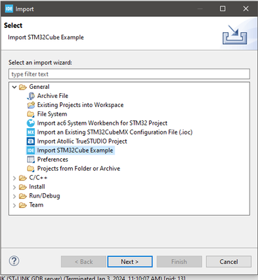

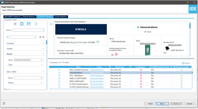

Hello @LPetr.1

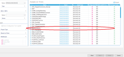

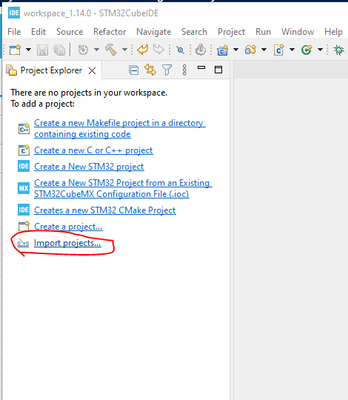

I suggest you to import 32L0538-Discovery Demonstration in this way:
1°) Start from STM32CubeIDE, and in Project Explorer select Import projects...
2°) In import Wizard choose STM32Cube Example, and click Next.
3°) In the example selector, set the Board filter to STM32L0538-DISCO, the search in the project list Demonstration project. Then click Next and Finish to copy the full project and libraries in your STM32CubeIDE workspace. The folder SW4STM32 will be migrated to STM32CubeIDE.
4)) After that, you can edit, compile and debug the Demonstration project with STM32CubeIDE.
if you check Project Properties, in Resource, Linked Resources, you will find the Path variables PROJECT_LOC is located in your workspace.
Let me know if it help you?
Best regards.
Romain
2024-01-03 2:43 AM - edited 2024-01-03 2:46 AM
Yes I am able to compile and flash the device using the methods you have suggested above! Thank you very much. This is much easier than what is explained in the Migration guide document.

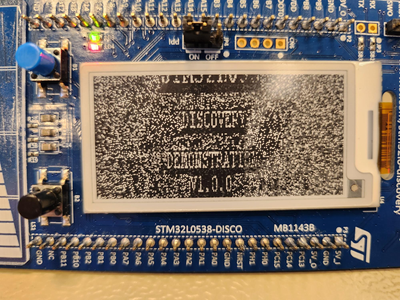

Unfortunately, despite the fact that I was able to compile the code and flash the board, I cannot get the Display to work properly. Perhaps this is due to damage flex cable as I have noticed a small tear at the end of the cable.
The small tear can be seen below:
2024-01-03 3:45 AM - edited 2024-01-03 3:51 AM
AFAIK there are two different versions of the 'L0 Disco board, with different e-paper display. And old demo won't properly support the newer version.
Check the Disco's user manual, schematics, compare to the code you have.
[EDIT] https://community.st.com/t5/stm32-mcus-embedded-software/stm32l0538-disco-demo-program/m-p/82762
2024-01-03 4:16 AM

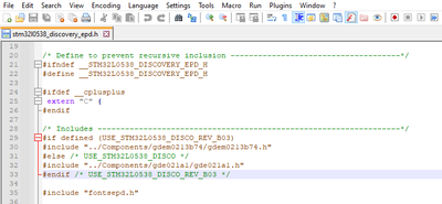

For the new revision of STM32L0538-Disco RevB03, the epd display driver supporting gdem0213b74 is implemented in the STM32Cube_FW_L0_V1.12.2.
I suggest you to change the global define into project -> Properties -> C/C++ Build -> Settings -> GCC Compiler -> Preprocessor, and change USE_STM32L0538_DISCO by USE_STM32L0538_DISCO_REV_B03
2024-01-03 5:16 AM - edited 2024-01-03 5:23 AM
I have replaced USE_STM32L0538_DISCO with USE_STM32L0538_DISCO_REV_B03 and now I can no longer compile the code

That is because I have followed RomainR. instructions provided above to create a project based on the STM32L0538Discovery Demonstrations which is probably based on the old version (not REV B03).
and I do not have the required driver source and header files for the new revision board

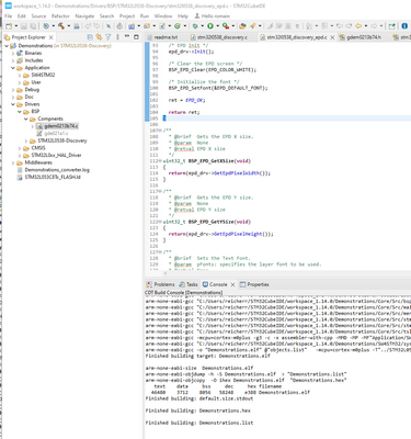

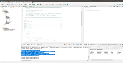

2024-01-03 5:49 AM
You get this linker error because Drivers\BSP\Components\gdem0213b74\gdem0213b74.c is missing in the project
Drag "gdem0213b74.c" from location and link it in the project structure.
And exclude from build the "gde021a1.c" file.
See my Project explorer below, and the project will compile/link:
