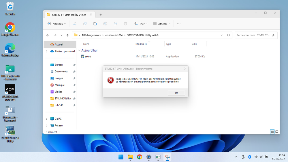

I have a new PC Windows and and I have this error when I start the software STM32 ST-LINK Utility (file in attachment)
It misses dll file (mfc140.dll)
And idea please?
Thanks
Arnaud
2023-11-17 8:22 AM
Thanks for your feedback.
I think that I have found the problem, it misses all .DLL file in my computer , I need to download Microsoft visual c++ from the last years on the PC.
BR
Arnaud
2023-11-17 2:49 AM - edited 2023-11-17 5:14 AM
Hello @Arnaud1
I've tested and it works with no problems for me. I think the problem is related to your own environment.
I suggest you to:
PS:
you mentioned having a new windows PC.
Best Regards.

2023-11-17 8:38 AM
Great to know about that. If you're problem is solved, chose the solution as best answer. It may be useful for other users.
Best Regards.
STTwo-32
2023-11-17 8:49 AM
Microsoft Visual C redistributables are needed for several tools, Microsoft doesn't install them by default, and doesn't want tool vendors to introduce their own .DLLs all over the place.
My go-to resource for this issue is https://www.techpowerup.com/download/visual-c-redistributable-runtime-package-all-in-one/
