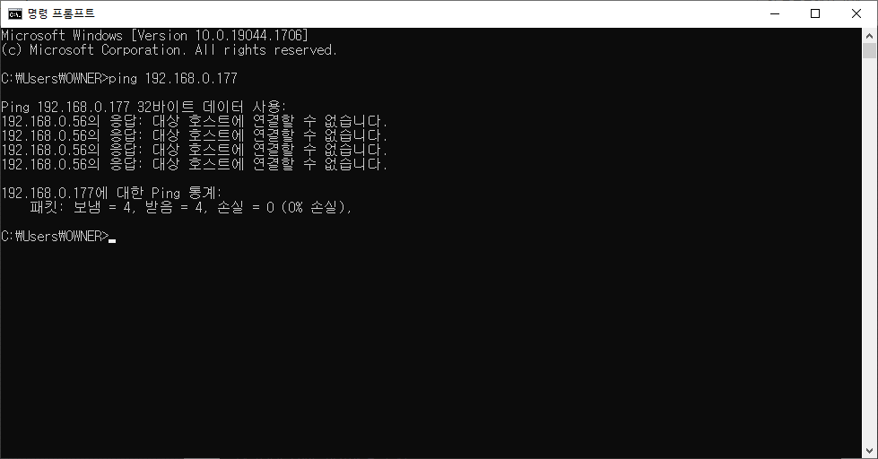

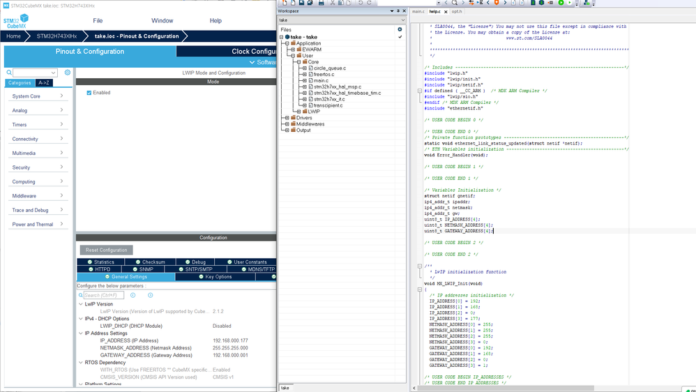

I'm trying to implement a server with eth+lwip with stm32, but it worked well when I debug it, but it didn't work when I tried to turn it off and on without debugging, so I'm trying this and that, but I'm not even pinging it
It says that the phenomenon shown in the image occurs when the corresponding ip is not working, but the ip is set to fixed, but it is not workingYes
Is there a way to solve this situation where both ping and connect worked well when debugging, but we can't do it without debugging?
