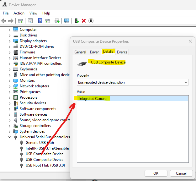

@Javier Muñoz Windows has so called device install (Di...) API for reading properties of devices and discovering their connections/dependencies. This is documented in what once was MSDN.
The Device manager show many of these properties in the details tab:
The name string from the device or function descriptor is "Bus reported device description". (this is optional, some devices do not have it)

It looks like that's just for composite devices. I'm using a CDC only at the moment.
