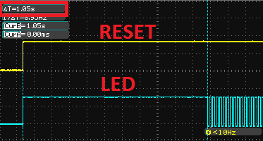

I've tried to create a simple project which includes 2 threads. Each thread toggles two separate pins respectively . To create a 10 ms delay, I am using tx_thread_sleep (TX_TIMER_TICKS_PER_SECOND is 100) . Everything works okay, however, I've noticed that it takes too long for a pin to be toggled the first time after reset (~1 s, see the example below). Then it works properly. If I delete tx_thread_sleep function and change it with HAL_delay, then it behaves after RESET as expected. What can cause this issue?

Is the initial configuration of those two pins high (see MX_GPIO_Init()). If so, it looks like it takes 1 second from reset to when your tasks start toggling the pins. So what else is your program doing on startup? Waiting for a slow oscillator to start (32KHz crystal)?

Hello, the initial configuration is low. So it seems that the thread starts to execute (toggles the pin from low to high after RESET), proceeds to tx_thread_sleep and then the delay for 1 s is observed. When the thread starts to execute over again, then there is no problem with tx_thread_sleep. I've also tried debugging the code, the return value of tx_thread_sleep is always TX_SUCCESS.
