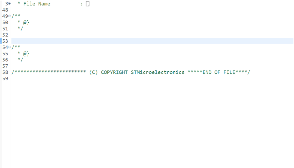

I am experiencing some problems when I set up the STM32L432KCU6 NUCEO-L432KC wiith FreeRTOS.
The driver files containing HAL are causing compilation errors (see attached screenshots) when used in eclipse.
What could be the reason for this?I haven't written any code in the main yet, I am just trying to compile the given project as is.

2017-09-26 10:51 AM
Make sure your project's stm32l4xx_hal_conf.h flags all the modules you want pulled in.
You pass USE_HAL_DRIVER on the compiler command line and #include 'stm32l4xx.h' rather than 'stm32l4xx_hal.h'
2017-09-26 2:53 PM
My conf file is empty. Should I be adding code to it?
And i don't have any libraries included in my main either.
2017-09-26 2:54 PM
I just set up the project fro STM32CubeMX which generated these project files. I don't know where the templates are and whether or not I should be adding anything.
