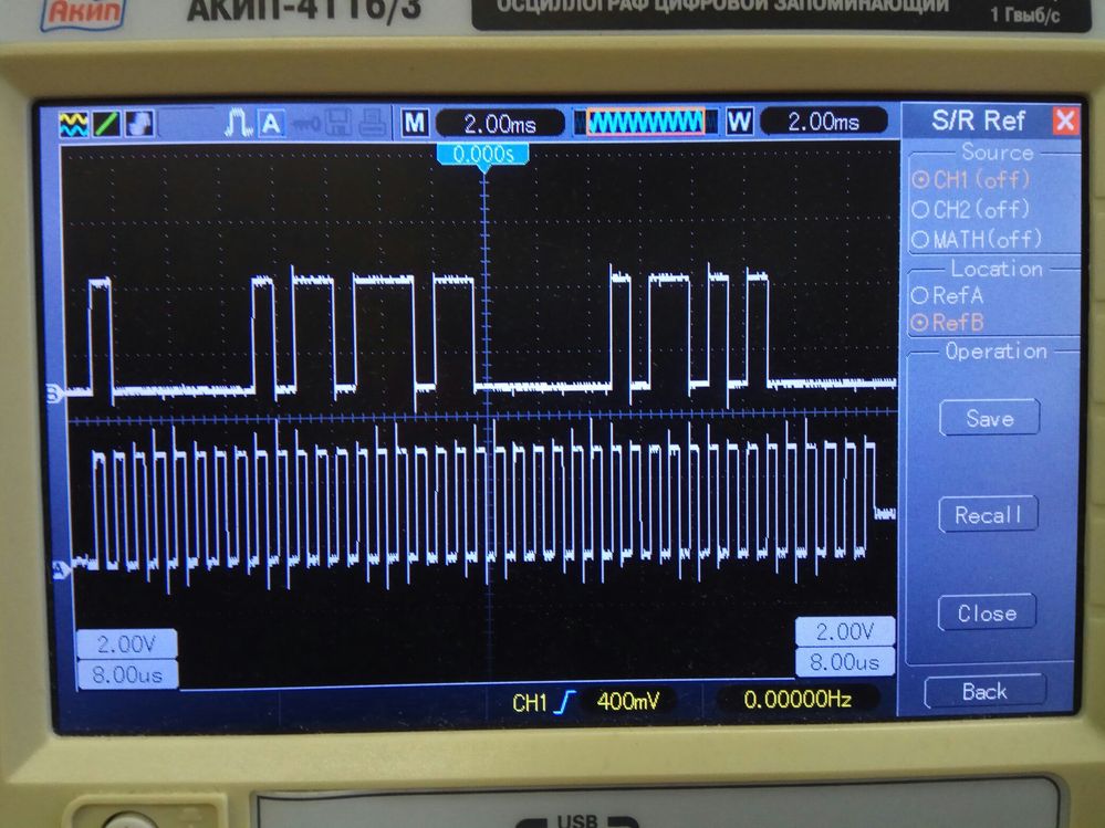

2017-09-26 2:33 AM
That's what I see on oscilloscope
2017-09-26 2:40 AM
I don't use Cube but the usage of Rx-only mode may be tricky, as it churns out clocks and may easily lead to overflow if not handled rapidly enough. Use normal duplex mode - you don't need to set the MOSI pin in GPIO at all.
2017-09-26 7:05 AM
Your scope trace doesn't match your code. your doing 8bit spi and askingfor 8bytes, i would have expect to see64clock cycles. Assuming your doing '3wire no busy mode' on your ADC, you only need 18 clk. So use 8bit x 3 (or maybe 7bit x 3).
I looked at the datasheet, your CONVERT seems wrong. Set Convert high, wait for DATA to go low, then read out data.
