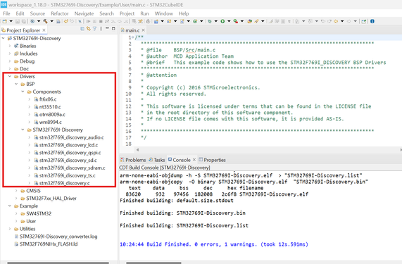

Hello @Cwoo.1 ,
You can get the BSP drivers integrated automatically by starting from one of the Cube firmware package examples and then opening that project in STM32CubeIDE.
Example procedure
So, instead of adding BSP “from CubeIDE”, you start from an example that already includes BSP, open it in STM32CubeIDE, and the IDE integrates all BSP sources and paths for you automatically.

Hello @Cwoo.1
You have to integrate the BSP drivers manually to your project.

Hello @Cwoo.1 ,
Example procedure
