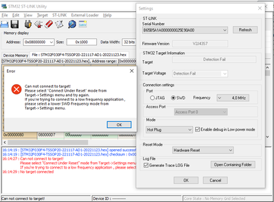

16:19:16 : Can not connect to target!
Please select "Connect Under Reset" mode from Target->Settings menu and try again.
If you're trying to connect to a low frequency application , please select a lower SWD Frequency mode from Target->Settings menu.
16:19:44 : No target connected
Hi this the error im facing when try to program using stlinkV2 on a custom board
Tried switching to powerdown mode also and also checked the connections of pcb
what could be the issue

First, ST-Link Utility tool is obsolete so please use STM32CubeProgrammer instead.
Second, check the power supply of your MCU.
Third: are you using one of low power modes in the program already loaded in the MCU?

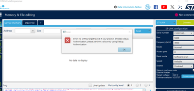

2024-10-22 9:46 PM
i have the same issue i used the STM32CubeProgrammer but is not connecting please help me
