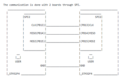

You can inspire from the example provided in the F4 cube package here.
2025-07-18 6:21 AM
I'm sorry, but this sample is completely useless.
My main problem is syncronized packet transfer, which requires more complex solution.
Maybe you have another version(s)?
