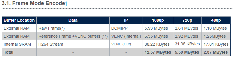

Do you know where I can find the example that was used to take the VENC power measurements as outlined on this Wiki page ?
I can't seem to find it under the Applications and Examples in the STM32CubeN6 v1.2.0
Specifically I want to see how the part was configured to support the 1080p resolution.

2025-07-21 10:18 PM
Thank you @DanielS for your feedback.
Adding the 1080p support would be great, thank you.
Specifically how to manage the memory around buffering the camera frames in External memory, or using the "Slices".
