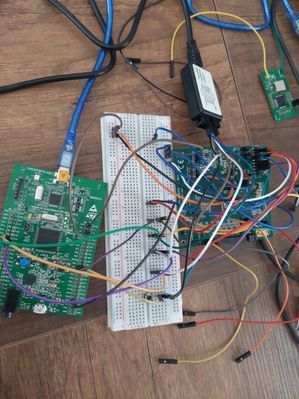

How is it wired? Show pictures. MISO at 0xFF or 0x00 generally indicates wiring is not as expected, or pins are already in use, or some other setup issue.
2025-06-19 5:38 AM
I am connecting pins using a breadboard. I tested the pins with a short circuit test all of them are connected. I am supplying AVDD and DVDD with 3V. Thanks for your reply @TDK
2025-06-19 6:12 AM
What pin is used for MISO? Is it in use by something else on the STM32F407G-DISC1 board? If you set that pin to output push/pull and disconnect from the ADS chip, can you toggle it and observe on the scope?
If you connect MOSI to MISO, do you read back the same data you're sending out?
2025-06-19 6:20 AM
2025-06-19 6:49 AM
No, I don't see any misconfiguration in what is presented. I suspect it's a hardware issue, not software. STM32 seems to be doing its job.

Hello @Omerbzkt
Please use a short cable with wire wrapping to connect your device

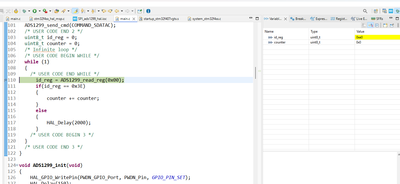

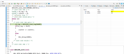

2025-06-21 5:22 AM
I made some adjustments to my code, and now I can see certain values. However, when I attempted to read the register value, it changed every time. I did not understand which part was problematic. This is my latest code. As far as I understand, the timing of the SPI communication between ADS1299 is critical. Is there any suggestion for fixing this misreading? According to the datasheet, when the reset operation finishes, I have to see the 0x3E value in the register.

uint8_t id_reg = 0;
uint8_t counter = 0;
/* Infinite loop */
/* USER CODE BEGIN WHILE */
while (1)
/* USER CODE END WHILE */
id_reg = ADS1299_read_reg(0x00);
if(id_reg == 0x3E)
counter += counter;
else
HAL_Delay(2000);
