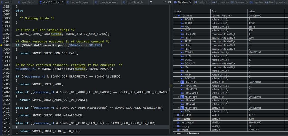

2025-03-26 1:31 PM - edited 2025-03-26 1:38 PM
This is the point where the HardFault occurs. With the data given on the right (collapsed structures only hold zeros), hitting "Step Into" it goes directly into the Hard Fault.
SDMMC_GetCommandResponse just returns SDMMCx-->RESPCMD which equals SD_CMD. So the if-statement in line 1395 should be skipped and the programm should continue at line 1401. But when setting a breakpoint on 1401, it goes to the HardFault just as said above.
Does this help to narrow down the problem in any way?
