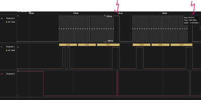

In release build the SPI CLK line remains high for too long, after the last bit of a transmission has been sent.
This results in the (software) CS line going high before the CLK returned to 0 (the DAC7562 slave does not like that)
How it looks like in Release:

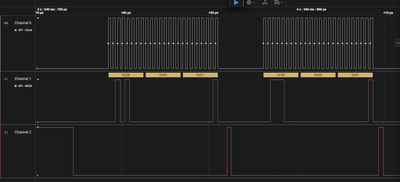

How it looks like in Debug (correct):

2025-08-09 6:44 AM
It's probably floating which would be apparent on an analog capture.
> SPI_MASTER_KEEP_IO_STATE_DISABLE
Set this enabled if you want the pins to keep their state.

2025-08-09 7:08 AM
Yes, thanks! Have a nice weekend
