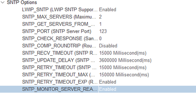

1: IOC file setup (within LWIP setup)
following is custom code written to test sntp setup:

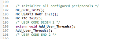

}to run this code created a new file and added to main.c as

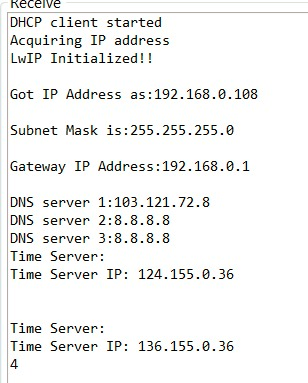

But when I debug i dint get correct SNTP server address.
I triend both ip and dns method.
checked for dns setting of sntp

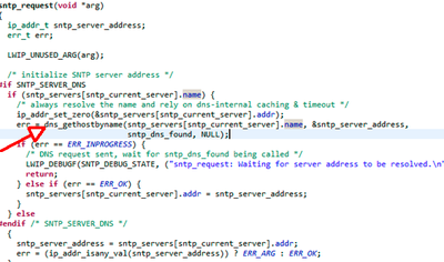

I may be getting error in sntp.c file of lwip in line
Any help please.
Thank you in advance!
2023-11-11 7:06 AM
Which error do you see there? ERR_INPROGRESS or other?
2023-11-13 8:38 AM
the dns query is unable to find correct ip.
also the direct ip method without dns is also not working. as sntp server is set to random value.
