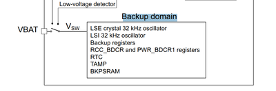

To retain the content of the RTC backup registers, backup SRAM, and supply the RTC when VDD is turned off, the VBAT pin can be connected to an optional standby voltage supplied by a battery or by another source.
To allow the RTC to operate even when the main digital supply (VDD) is turned off, the VBAT pin powers the following blocks: (refer to the datasheet)

The Vbat pin needs to be powered to preserve the content of backup registers. it can be powered either by VDD or an external battery.
As mentioned in AN5373- Power supply schemes: If no external battery is used in the application, it is recommended to connect the VBAT pin to VDD with a 100nF external ceramic decoupling capacitor.
it worked in standby mode because the switch between VDD and VBAT is controlled automatically by the brownout reset circuitry or the BOR is not available in Shutdown mode.
