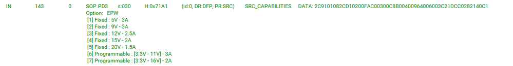

2024-12-05 11:43 PM
Hello! you were right!
i purchased a USB C PD 3.0 charger and now i see his output option in the trace in cube monitor UCPD
one last question, i see there is the fixed 12V option but i don't have 12V in the PDO configuration in cubeIDE , why?
i have the option of variable supply, if i enter for example 3.3V - 7V which voltage the charger give to me? i imagine there is a standard behaviour that a charger have to be
There is a tutorial from ST of how to use the USBPD module other the video on youtube? maybe a explanation about how to use the module for multiple voltage?
thank you!
2024-12-06 12:24 AM
Regarding the documentation, you can find different resources at the bottom of this page: STM32 solutions for USB Type-C and Power Delivery - STMicroelectronics.
The SRC_capabilities in your trace are what your charger is capable of. Your STM32 acts as a sink and so the PDO configuration you make in cube IDE is effectively what your sink is capable of. These are two different things, but to have a 12V contract between the two, you must need both device to have a 12V capability.
If you want to select the PDO number 6 or 7 from your charger, then you must change the PDO type in the sink, it is a programmable PDO instead of a fixed one.
Which voltage the charger will give you in this case is dependent on what you ask. The Sink PDO is not the request, it is the min/max capabilities. The request itself is called a "RDO", it is built in USBPD_DPM_RequestMessageRequest function, there you will need to build the proper RDO to request the right voltage from the source.
Regards
2024-12-06 12:32 AM
thank you for the document!
i understand that, for me is "strange" that i cant with cube select a 12V sink capability , its a "stadard voltage" 12V, why is not an option? i was thinking is out of psecification but many charger have the 12V capability
ok, i see the option in the cubeide configuration
OK, i have to search in the examples, thank you!
best reguards
2024-12-06 12:44 AM
Ok, I understand your question now. In fact, 12V is out of spec. See this extract from PD 3.1 spec:
That is why you cant select 12V from CubeMX. But anyway you can still put 12V in the usbpd_pdo_defs.h file "by hand" if you want, it will not be in line with the spec, but I will most likely work.
Regards
