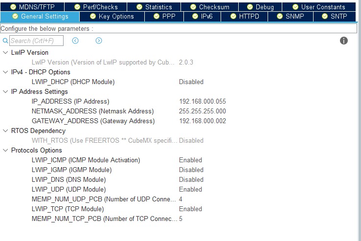

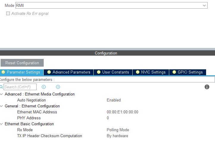

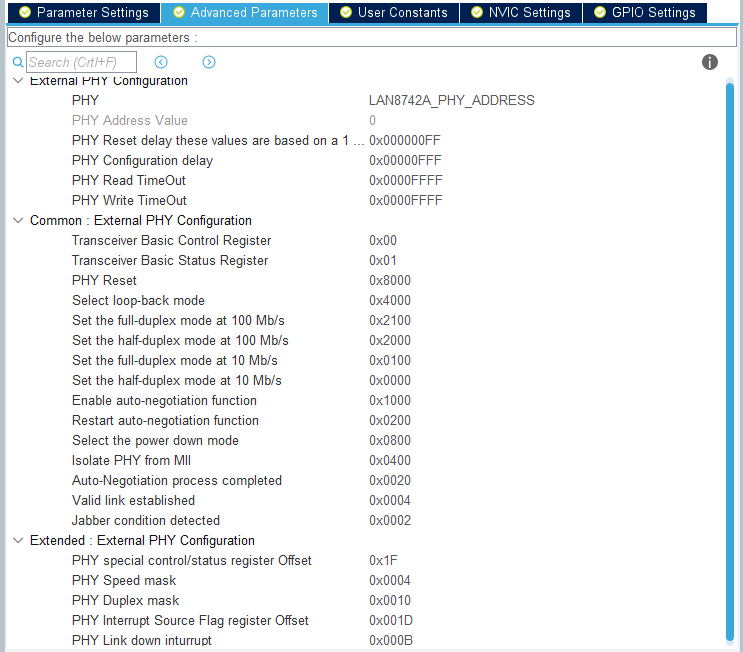

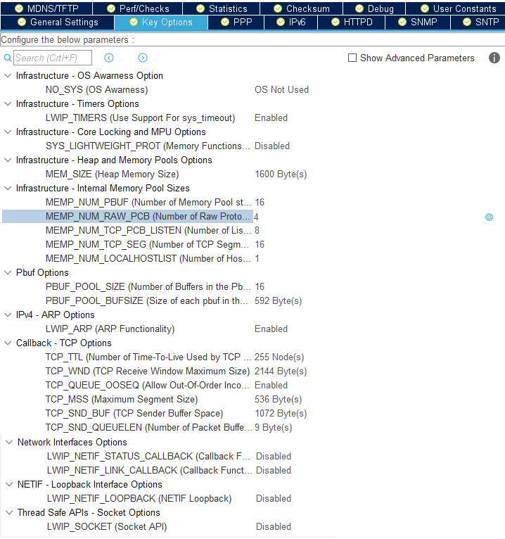

Here are my settings for the ETH:
And for the LwIP:
Here is my main.c code:

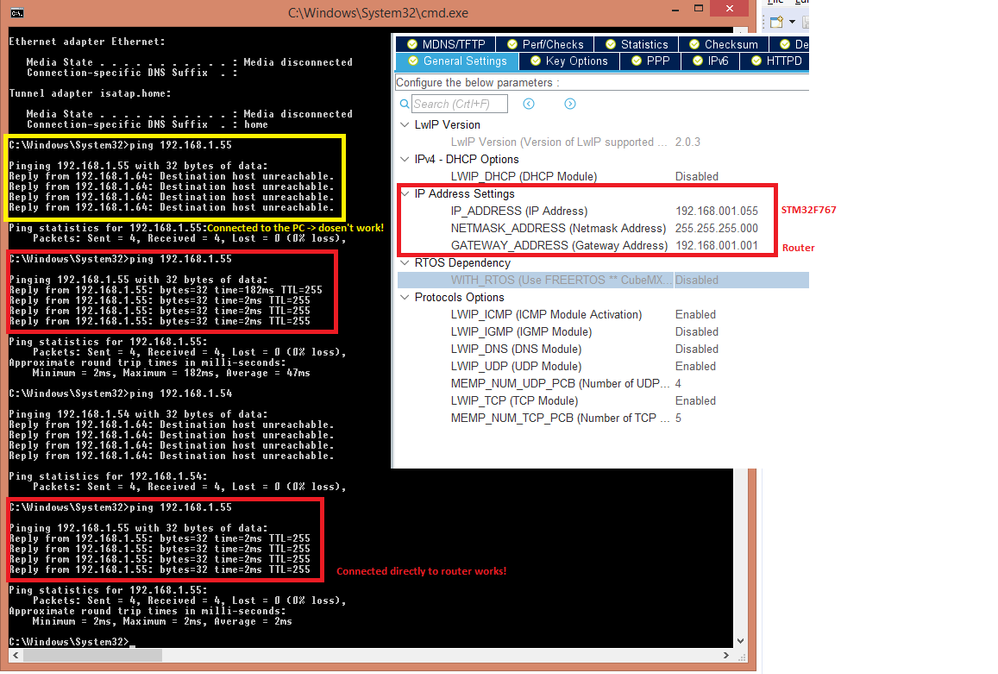

2020-10-20 1:53 AM
I will just continue this self-discussion :)
After some try's with my router I was able to ping my F767 Board, but only when it's cable connected to the router. The ping was sended from my PC connected to the same network as the router.
Here a picture of the ping details:
The question is: How can I ping the F767 Board when is directly connected to my PC and not to the router (with which settings) ?
Regards,
Gregor
