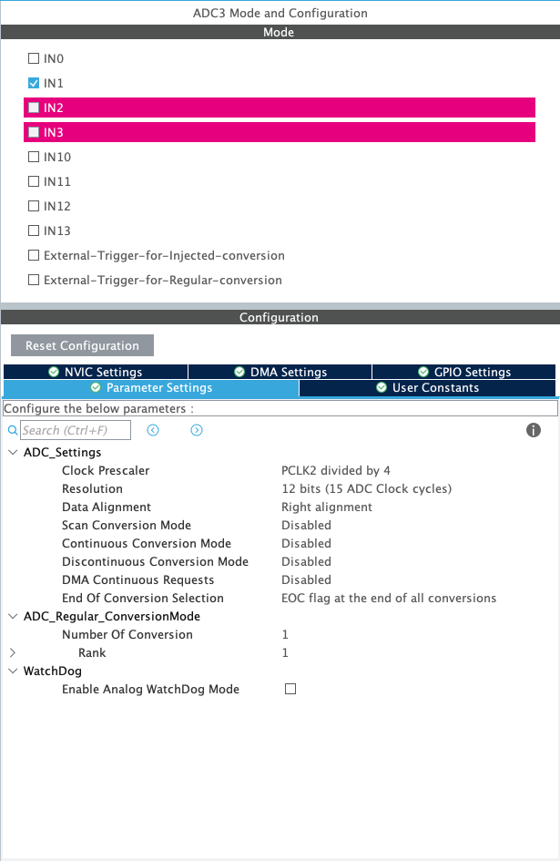

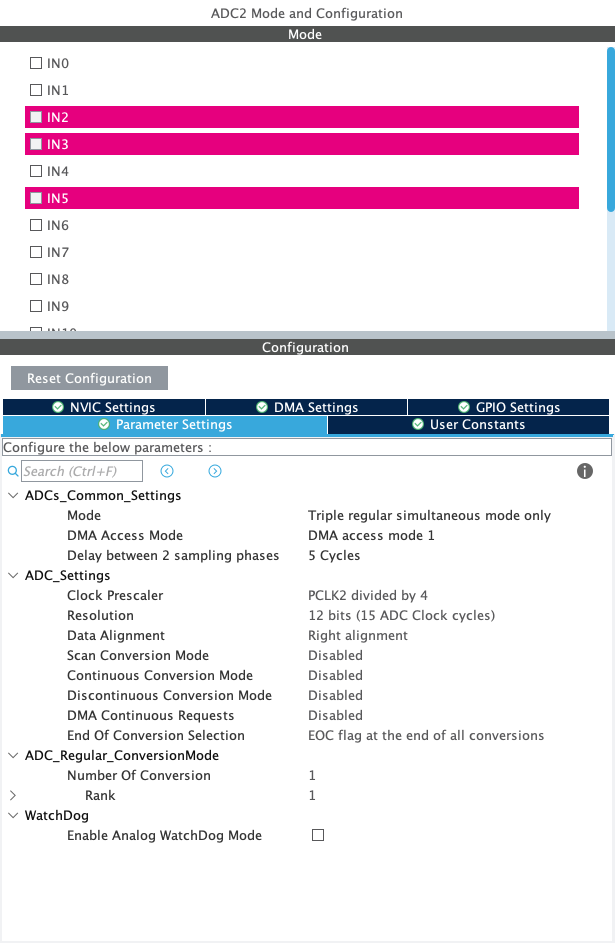

Hi, I'm having really a hard time setting up my ADCs to work with DMA using the STM32F429I-DISC1. My objective:
have a clock source from a Timer at a given frequency as trigger to the ADCs, each ADC would then read a specific pin (let's say ADC1-> pin_x; ADC2->pin_y and ADC3->pin_z). Since nothing is working regardless of the configuration I set, I'm trying with very big time intervals to avoid busy bus and so on. So I've set the TIMER8 to have a period of 5s and tested it individually with the interrupt enabled to make sure it is triggering and having the correct interval. Now the idea is to trigger the ADCs to perform a few conversions of the pins in order to do some oversampling.
Here is my ADCs configurations:
The ADC3 is identical to ADC2. Timer8 Trigger Event Selection is set to "Update Event".

My ADC initializing functions:
static void MX_ADC1_Init(void)
/* USER CODE BEGIN ADC1_Init 0 */
/* USER CODE END ADC1_Init 0 */
ADC_MultiModeTypeDef multimode = {0};
ADC_ChannelConfTypeDef sConfig = {0};
/* USER CODE BEGIN ADC1_Init 1 */
/* USER CODE END ADC1_Init 1 */
/** Configure the global features of the ADC (Clock, Resolution, Data Alignment and number of conversion)
hadc1.Instance = ADC1;
hadc1.Init.ClockPrescaler = ADC_CLOCK_SYNC_PCLK_DIV2;
hadc1.Init.Resolution = ADC_RESOLUTION_12B;
hadc1.Init.ScanConvMode = DISABLE;
hadc1.Init.ContinuousConvMode = DISABLE;
hadc1.Init.DiscontinuousConvMode = DISABLE;
hadc1.Init.ExternalTrigConvEdge = ADC_EXTERNALTRIGCONVEDGE_RISING;
hadc1.Init.ExternalTrigConv = ADC_EXTERNALTRIGCONV_T8_TRGO;
hadc1.Init.DataAlign = ADC_DATAALIGN_RIGHT;
hadc1.Init.NbrOfConversion = 1;
hadc1.Init.DMAContinuousRequests = DISABLE;
hadc1.Init.EOCSelection = ADC_EOC_SINGLE_CONV;
if (HAL_ADC_Init(&hadc1) != HAL_OK)
Error_Handler();
/** Configure the ADC multi-mode
multimode.Mode = ADC_TRIPLEMODE_REGSIMULT;
multimode.DMAAccessMode = ADC_DMAACCESSMODE_1;
multimode.TwoSamplingDelay = ADC_TWOSAMPLINGDELAY_5CYCLES;
if (HAL_ADCEx_MultiModeConfigChannel(&hadc1, &multimode) != HAL_OK)
Error_Handler();
/** Configure for the selected ADC regular channel its corresponding rank in the sequencer and its sample time.
sConfig.Channel = ADC_CHANNEL_1;
sConfig.Rank = 1;
sConfig.SamplingTime = ADC_SAMPLETIME_3CYCLES;
if (HAL_ADC_ConfigChannel(&hadc1, &sConfig) != HAL_OK)
Error_Handler();
/* USER CODE BEGIN ADC1_Init 2 */
if(HAL_ADCEx_MultiModeStart_DMA(&hadc1, test, 3) != HAL_OK)
//if(HAL_ADCEx_MultiModeStart_DMA(&hadc1, test, 5) != HAL_OK)
//if(HAL_ADC_Start_DMA(&hadc1, (uint32_t*)&(adc_L.val), 1) != HAL_OK)
/* Start Conversation Error */
Error_Handler();
/* USER CODE END ADC1_Init 2 */

Hi @feliperibas;
After some tinkering here I think I have a working example. I have a spare STM32f44 Nucleo board, and I wanted to try to set up a simple isolated test apart from my main project to see if I could understand how this works.
(forgive me if I overexplain anything here, this is me trying to verify what I think I've learned more than anything else)
For me, there are two things to wrap my head around: there's the triggering of the ADC by the timer as we want, then there's the issue how to properly read the data we want.
I found that configuring my ADC1/2/3 as follows produces the right timing. There are two parameters that were a bit confusing for me here:
I think the EOC flag in this case might be a little irrelevant, as I am only performing a single conversion per ADC anyway.
I didn't see the actual code you're using to start/read the ADCs (those seem to be in a separate task function somewhere for you?), but here is what I am doing to actually start the ADCs:
// Start the two slave ADCs first
HAL_ADC_Start(&hadc2);
HAL_ADC_Start(&hadc3);
// Then we start the master thusly:
HAL_ADCEx_MultiModeStart_DMA(&hadc1, (uint32_t *) adc_vals, 3);
// The above "arms" all of the ADCs. To begin triggering
// conversions, we start our timer channel:
HAL_TIM_OC_Start(&htim4, TIM_CHANNEL_4);
Next, we can turn our attention to how to read the results. Here's what I have:

2025-11-23 1:00 PM
So, I had given up using DMA and was just using Regular Simultaneous Triple Mode but manually starting ADC2 and ADC3 with HAL_ADC_Start() and ADC1 after them with HAL_ADC_Start_IT() and having one callback for ADC1 where I would read all ADCs at once. ADC1 was being triggered by a Timer. This used to work until i had some unexpected behavior: pulling ADC3 pin to 3v crashed my application. I noticed that both ADC1 and ADC2 behaved like open-drain without pull-up or pull-down and I could connect to anything between 0v and 3v without problems. ADC3 however, despite all the same configuration (no pull-ups or downs, open-drain, analog mode etc), was behaving as if it would have a pull-down, giving always 0 when not connected and measuring 3v difference to the 3v pin. When pulling it to 3v, the ADC would capture this 3v for a few miliseconds and then the application would break or exhibit some unexpected behavior. I thought it was a HW problem but I think it was due to the fact i was accessing ADC3 registers when using Triple Simultaneous mode, where the user is supposed to read stuff from the common register. So I went back to the Regular Simultaneous Triple Mode with DMA, and now it works! Finally. So here is what I figured it out:
complementing to some stuff pointer out by @sb_st :
- Continuous conversion mode is an ADC setting which decouples the ADC from the timmer, starting the next conversion immediately after the last one. As I was using the timer to make sure my intervals were constant, this must be disabled;
- DMA Continuous requests: this is also an ADC setting and it tells the ADC module to keep sending DMA requests uninterruptly, which is in my case also not desired as I only want to transfer the data once at end of conversion and wait for the next timer trigger. So also disabled
- DMA Circular mode: this one fills up the number of conversions to be made after finishing the last sequence. I left it disabled.
Now the important things:
1) quote from the manual RM0090 Page 403 talking about DMA Continuous Requests: "... the DMA bit is
not cleared by hardware. It must be written to 0, then to 1 to start a new transfer.". I am not sure if this is the DMA bit the manual is talking about but I put these two lines on my ADC Conversion Callback:
ADC123_COMMON->CCR &= 0xFFFF3FFF;
ADC123_COMMON->CCR |= 0x00004000;Which disables and enables DMA Mode from Common ADC Register. Commenting out these lines makes my code not work again.
2) Besides re-setting the DMA mode on the common ADC register, I also appended the following lines afterwards (still inside the ADC conv callback):
DMA2_Stream0->CR |= 0x10;
DMA2_Stream0->CR |= 0x01;Which re-enables the DMA Interrupt on my stream as well as enabling it again.
3) I enabled the ADCs global interrupts (NVIC) so the auto-generated code from STM32CubeIDE/MX calls the ADC interrupt handlers which check for OVR flag. In case overrun occurs, this also blocks further readings. This can be done directly on the registers as well but I used the callbacks so I only go through the handlers if an overrun occrus.
4) I've set up my global variable as an array of 3 elements of uint32_t. Then DMA set as "word" for peripheral and memory, only increment on memory. This setting is also probably better using "half-word" with different parameters, since ADC results are 16 bit but I decided to use 32bit as ADC_CDR is 32bit and it is working, so I havent tested with "half-word" yet.
Now my code works as expected, but I confess I still dont understand who re-fills my DMA->NDTR, since i am clearly not doing that manually after triggering the conversions during intialization (only once). But it does work somehow.
Here is the rest of my code.
