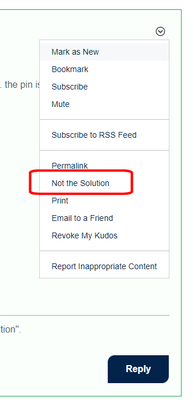

2024-02-19 7:19 AM - edited 2024-02-19 7:24 AM
You have to un-mark one before you can mark a different one
Clikck on the in the top-right of the post:
Then choose 'Not the solution':
#UnmarkSolution
