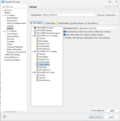

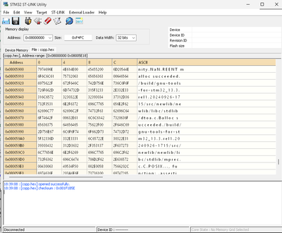

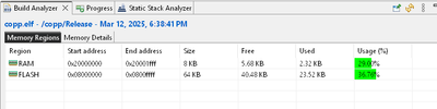

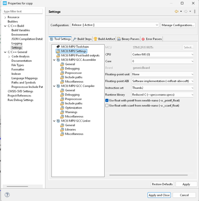

2025-03-12 8:44 AM - edited 2025-03-12 8:46 AM
@Andrew Neil I was trying to find this topic..
I used ST-LINK Utility to display hex file and as you see there is some link names. Tihs is a complete blank project and compiled with floating feature enabled as shown below pictures.
I also compiled as "debug" and "release" modes, the result is same on the hex file output.
Flash usage also looks like too much

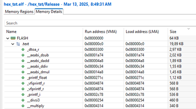

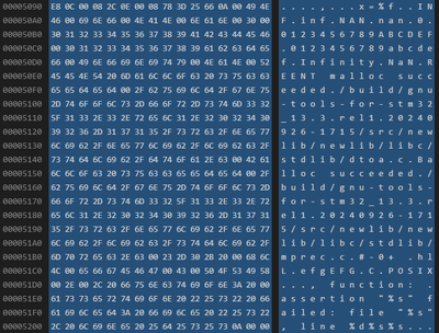

2025-03-13 12:57 AM
I could reproduce this behaviour.
- STM32CubeIDE 1.18.0 clean install on Win 11, no upgrade
- new empty STM32F051R8 project
- added your settings
- release config
- added code in main to force printf inclusion
volatile float x = 3.14159f;
printf("x=%f\n", x);
The created .bin contains "few" strings which are probably from assert statements in newlib:
But, the main contribution to the .bin file size is from the printf floating point support:
hth
