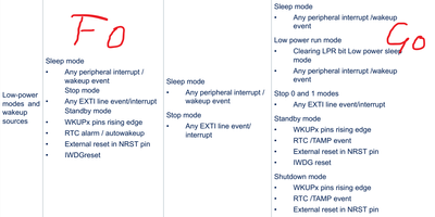

2024-02-29 12:33 AM
hi STTwo-32:
I have reviewed the AN5145 document several times, but there are differences in the interrupt part between the F0 and G0 chips, as shown in the screenshot:
But I have modified the program many times for STM32G0, and since there are no routines in this area, it never runs. I have referred to the RM0444 document for the above code. Due to some registers in STM32G0 not being present on stm32f0, I am not sure where the problem lies? Can you help me take a look?
