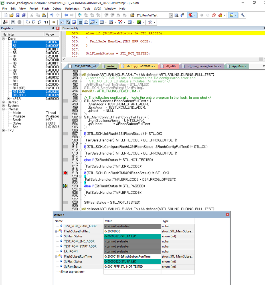

I'm using the STM32F767 MCU and Keil compiler. The Keil version is Fusa 16.2.
When applying the STL library in the Keil compiler environment, a rom test failure occurs.
STL version is 4.0, and it was applied as in the guide document, but STL_Lib responds from rom test to fail.
The keil compiler is the version of fusa 16.2.
After compiling the project, it seems to be CRC sorting using the file "STM32_Programmer_CLI.exe".
I don't know where to fix it because the library file responds with an error.
Q1) Request Keil compiler to check how to set up
Q2) I looked up the posts in the community and they told me to sort the size to 8, which part of the setting should I change?
Q3) If I can use the STL Lib version lower, is there a source for the STM32F7xx series? I don't think I can download it on the homepage except for V4.0.
