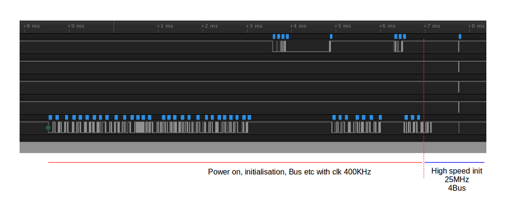

Hi I am having the same problem with STM32H7 with a BUS_WIDE=4 + DMA. I have tried to change the clock to different low speeds without success.
I know the problem is the FIFO because I get and overrun error similar to SStar.1. I've checked the set up of the SD card and is correct because I managed to make it work a 1 Bus 150 kHz without DMA.
I also checked data passing throughout the channels and all looks correct. I don't know if you can share with me other tricks that you did see if I am not missing something.

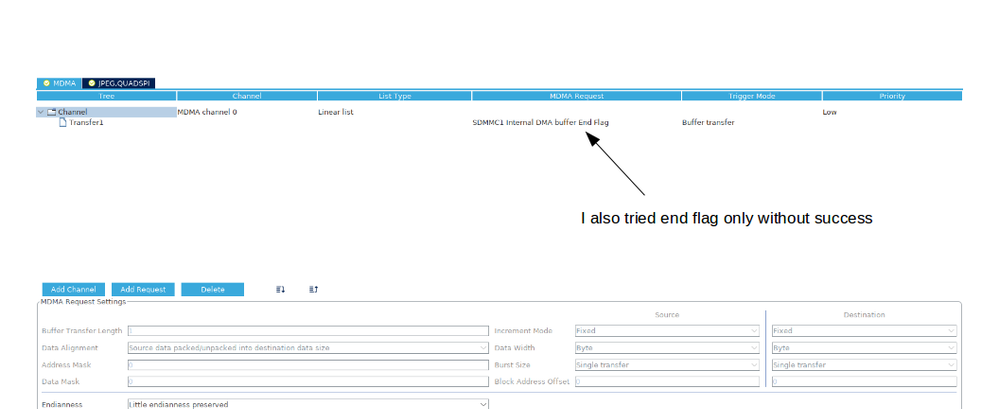

Regarding the DMA I am using a MDMA for the SDMMC
I also followed the advice of this link to change the SD_read/write on the sd_diskio to make sure the DMA readblocks is called.
Any help would be great.
