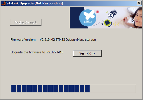

This sounds like an issue that was seen with older ST-LINK firmwares used on NUCLEO and DISCO boards, get the current ST-LINK Utilities, and have it update the ST-LINKs you are using.
2016-09-01 4:03 PM
Hy,
that was it!We’re moving the ST Community to a new platform to give you a better and more reliable community experience.
