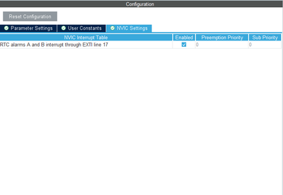

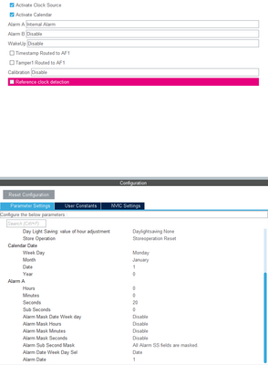

And here how i configured it in HAL

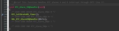

And here I set a breakpoint in the interrupt file:

2023-10-31 5:07 AM
It's about Alarm Mask.
Alarm Mask is used for ignore that field to compare with your alarm time.
As your config, You have no mask in any field so RTC are going to alarm on every 0:0:20.000 on Monday.
and If you want to alarm at second 20th every minute, you should try to mask in another field except second field.
RTC is going to compare your alarm time in second field 20th to RTC time in second field and alarm if it matched.

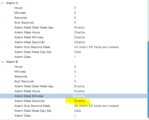

2024-01-27 8:00 AM
I too am having trouble with getting interrupts on seconds. I have set two alarms, one for 00:00:00 on alarm A, and that works, toggling the LED, but the seconds alarm never fires. I am guessing I have not set up the handlers correctly. The NVIC is checked. The above mentioned article appears to be a help, but I am not getting there.
Here is my stm32l4xx_it.d
void RTC_Alarm_IRQHandler(void)
/* USER CODE BEGIN RTC_Alarm_IRQn 0 */
/* USER CODE END RTC_Alarm_IRQn 0 */
HAL_RTC_AlarmIRQHandler(&hrtc);
/* USER CODE BEGIN RTC_Alarm_IRQn 1 */
/* USER CODE END RTC_Alarm_IRQn 1 */

Attached are my alarm configureations. I tried the seconds mask both ways, enabled and disabled with no difference.
