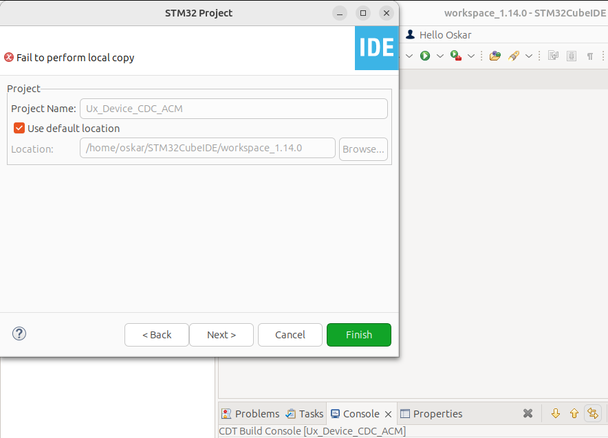

Then after a while there is an error as shown in the screenshot below.
At the same time this error is output in execution log:
2024-01-26 18:27:04,899 [ERROR] com.st.microxplorer.mcufinder.util.ExampleToolKit.processExtraFiles(ExampleToolKit.java:1585) - File not found: ../../../Utilities/Fonts/fonts.h
2024-01-26 18:27:04,903 [INFO] com.st.microxplorer.mcufinder.util.ExampleToolKit.copy_engine(ExampleToolKit.java:887) - [WARNING] Project 'Ux_Device_CDC_ACM' installed with Warning(s)/Error(s)
2024-01-26 18:27:04,903 [INFO] com.st.microxplorer.mcufinder.util.ExampleToolKit.copy_engine(ExampleToolKit.java:908) - [info] 2024/01/26 18:27:04
2024-01-26 18:27:04,925 [INFO] com.st.microxplorer.mcufinder.util.ExampleToolKit.elapsedTime(ExampleToolKit.java:1027) - [info] Elapsed time: 0h 1m 41s 874msThen I click Finish but it just does nothing and there is still the error.
The only way to continue is to click Cancel, it closes the popup and the example is gone ! Then I cannot even build it...
