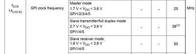

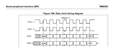

Read in rm of your cpu, what SPI can do:
So if you know the format (like 8bit words, clocked at rising clock) you could set the SPI to slave mode (= just "listen") and get the bytes clocked in at up to 50Mbit :

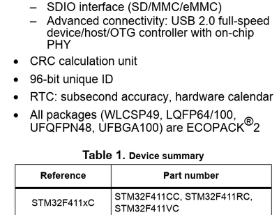

Or look for an STM32 with an integrated SDIO / SDMMC peripheral.
And learn about DMA, the best option for most high data rate interfaces. That way a DMA controller handles the data transfer from a peripheral into a memory buffer, and that mostly in the "background" without much CPU load.

@LCE , he has a F411 : with SDIO...
So its more "just playing around" . :)
