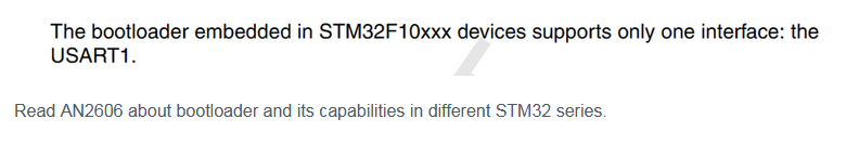

Hmm...the DFU bootloader was on UART (and is) at first, the USB or CAN etc. came later on newer, more powerful chips.
So if you use the first and oldest ARM / STM32 ever, dont expect same functions as on a 10 years more recent chip series.
In AN3156 is :
...as i wrote:
