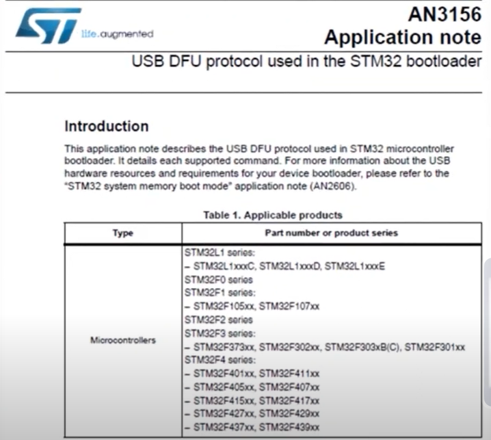

I'm not basing my information on the fact that the board simply has a USB connector... I'm basing it on the video (produced by ST themselves linked in my OP), and AN3156 which says that this chip has a built in DFU boatloader which allows USB enumeration (and subsequent update via STMCube Programmer).
2024-07-24 11:00 AM - edited 2024-07-24 11:04 AM
Your video 0:31 time show same info as AN2606 = only 105 107 have DFU. No 103 (bluepill).

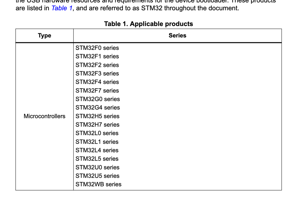

Yeah i saw that, but that video's 9 years old and if you pull the newest version of AN3156 off the ST site (rev 15) from feb 2024, that table has changed:

Yes, I understand. Just saying, that this is not mentioned in the newest version of AN3156, nor does the video linked mention that some chips won't support USB on the DFU FW.
