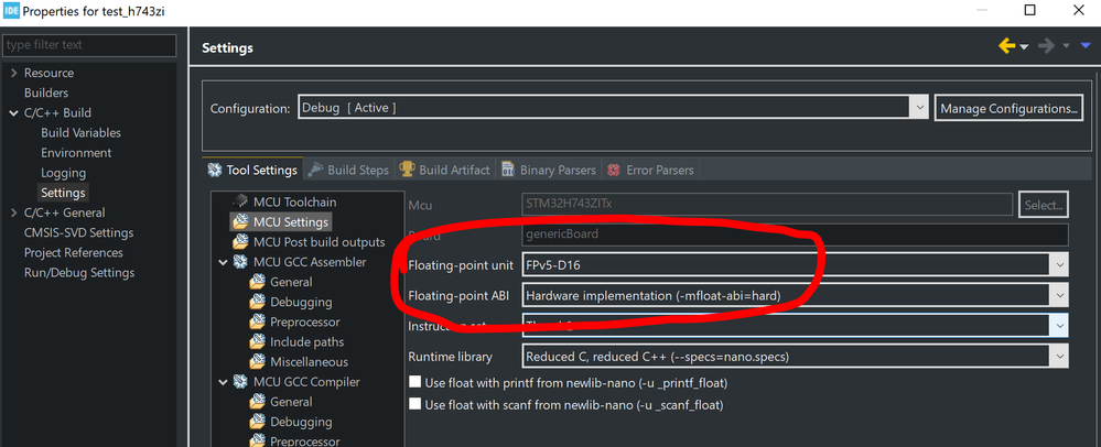

It needs to be enabled at compile-time in order for the compiler to generate FPU instructions, rather than emulating them in software. This is done in the IDE:
It also needs to be enabled in hardware when your program is starting up. In HAL, this is done with the __FPU_PRESENT and __FPU_USED flags.
Enabling the FPU is the default as far as I can tell.
